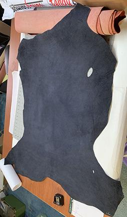

  2. FLAT BLACK COLOR CALF SKIN 5 3/4 sq ft x .7mm thick This piece is unique in the fact it has a suede finish on backside front is smooth. I think it could be used either side as finish side. $75.00 plus shipping

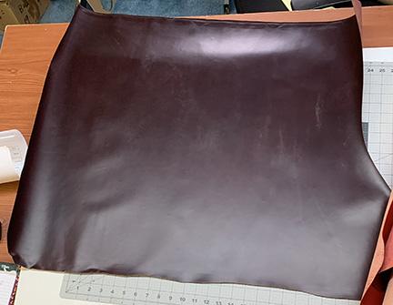

  4. YAPA CALF SKIN, Cordovan color .6mm thickness x 5.0 sq ft This is top quality skin I special ordered to be used for expensive pieces. $125.00 plus shipping

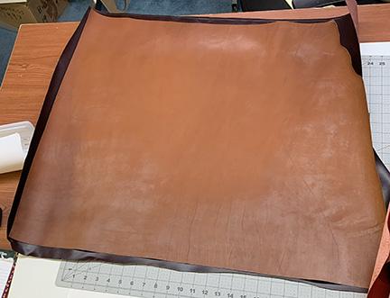

  5. YAPA CALF SKIN, LIGHT BROWN .6mm thickness x 5.0 sq ft This is a top quality skin I special ordered to be used for expensive pieces. $125.00 plus shipping
