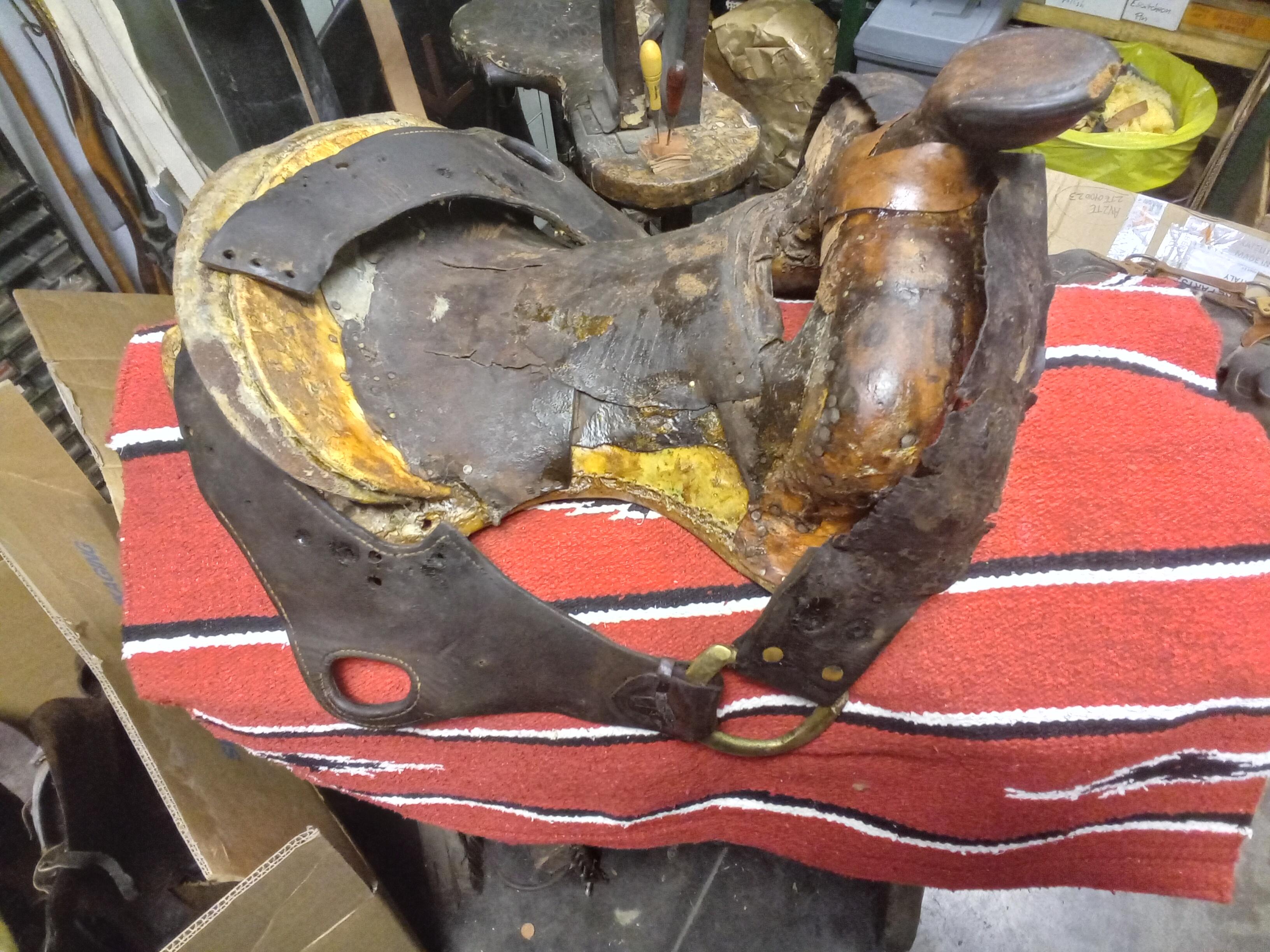

This is one from my Dad's collection. He always called it a "squaw" saddle (no offense to native Americans meant), though I don't know if that's the proper name. I'm not sure where he picked it up but it's old. He had a knack for collecting old western and ag paraphernalia mainly from the American southwest and rural west coast, and he also was around a lot of it during his years doing props and special effects in Hollywood, as he would buy or was given authentic artifacts to study or duplicate for film, and this could be one of those pieces. It appears to be a wood tree, wrapped in rawhide, and then wrapped in leather, with brass dome tacks added for embellishment. They also likely add some wear resistance on the edges. The rigging straps are held on with screws, but I think they are a later repair. The brass tacks seem advanced for a natives saddle? I'd be interested if anyone recognizes what culture, area, time frame, etc. this saddle is from. I have no intention of restoring or selling it. Periodically it comes down for a cleaning and soaping, bit otherwise it stays on the wall.
