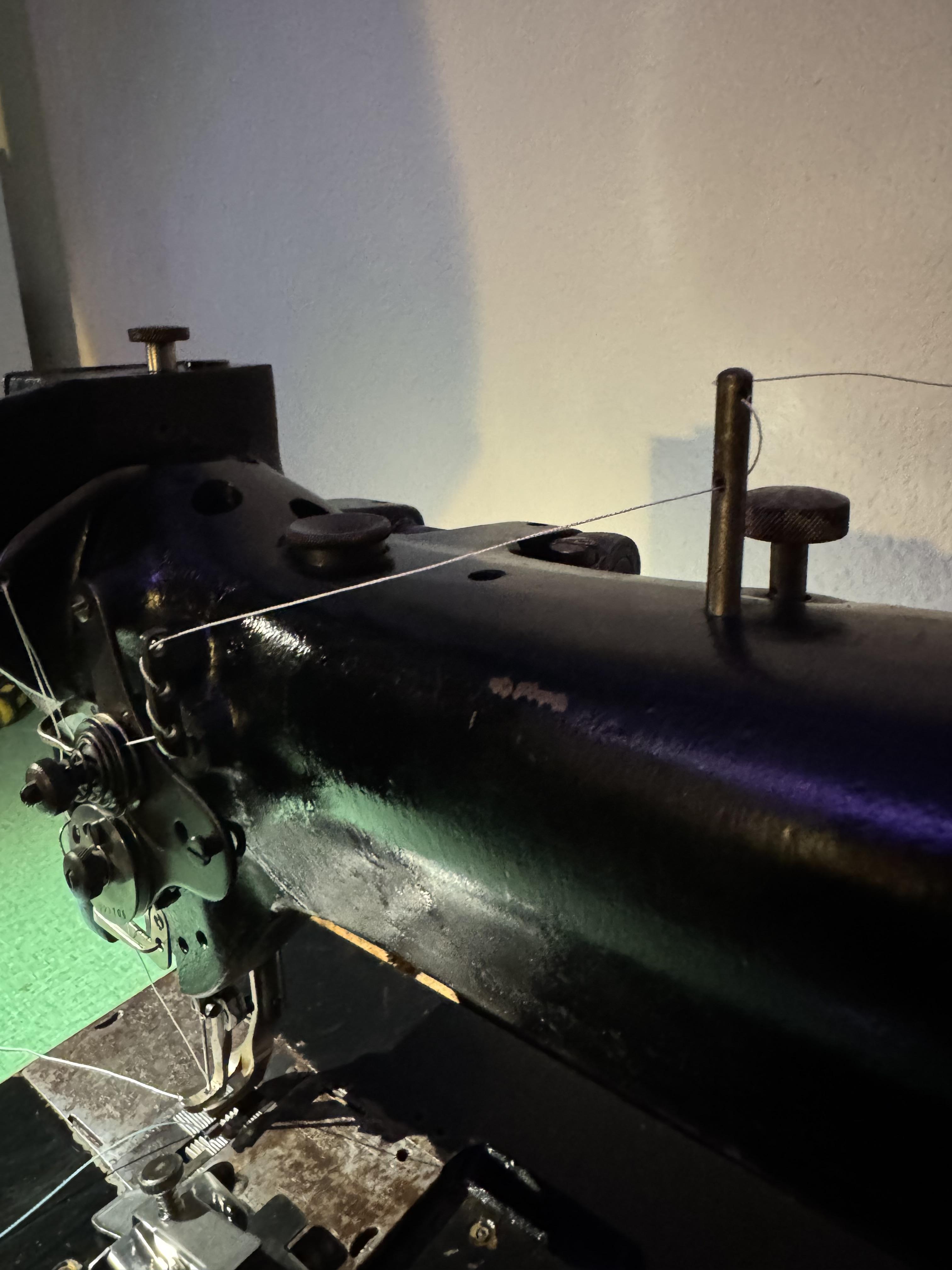

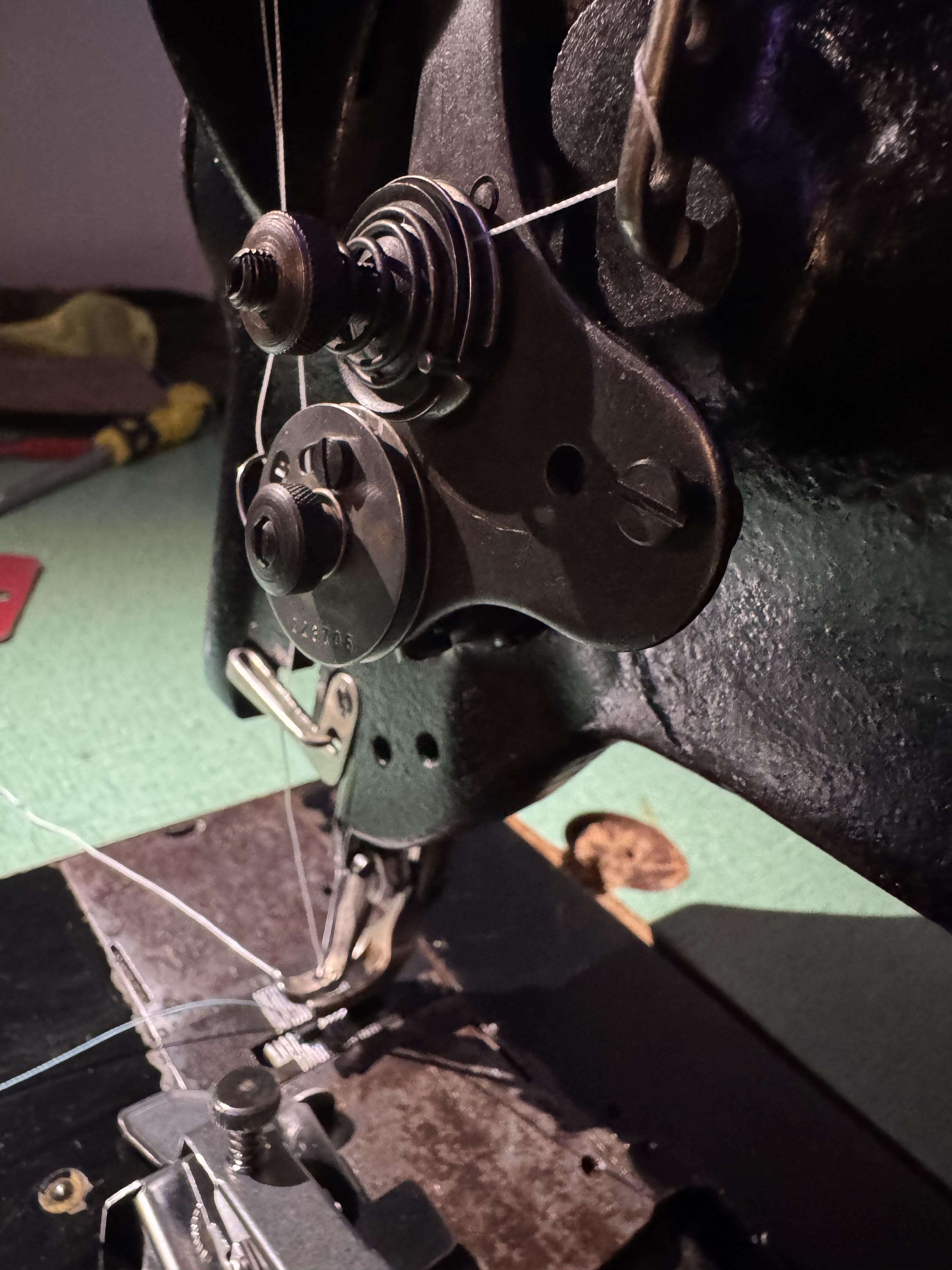

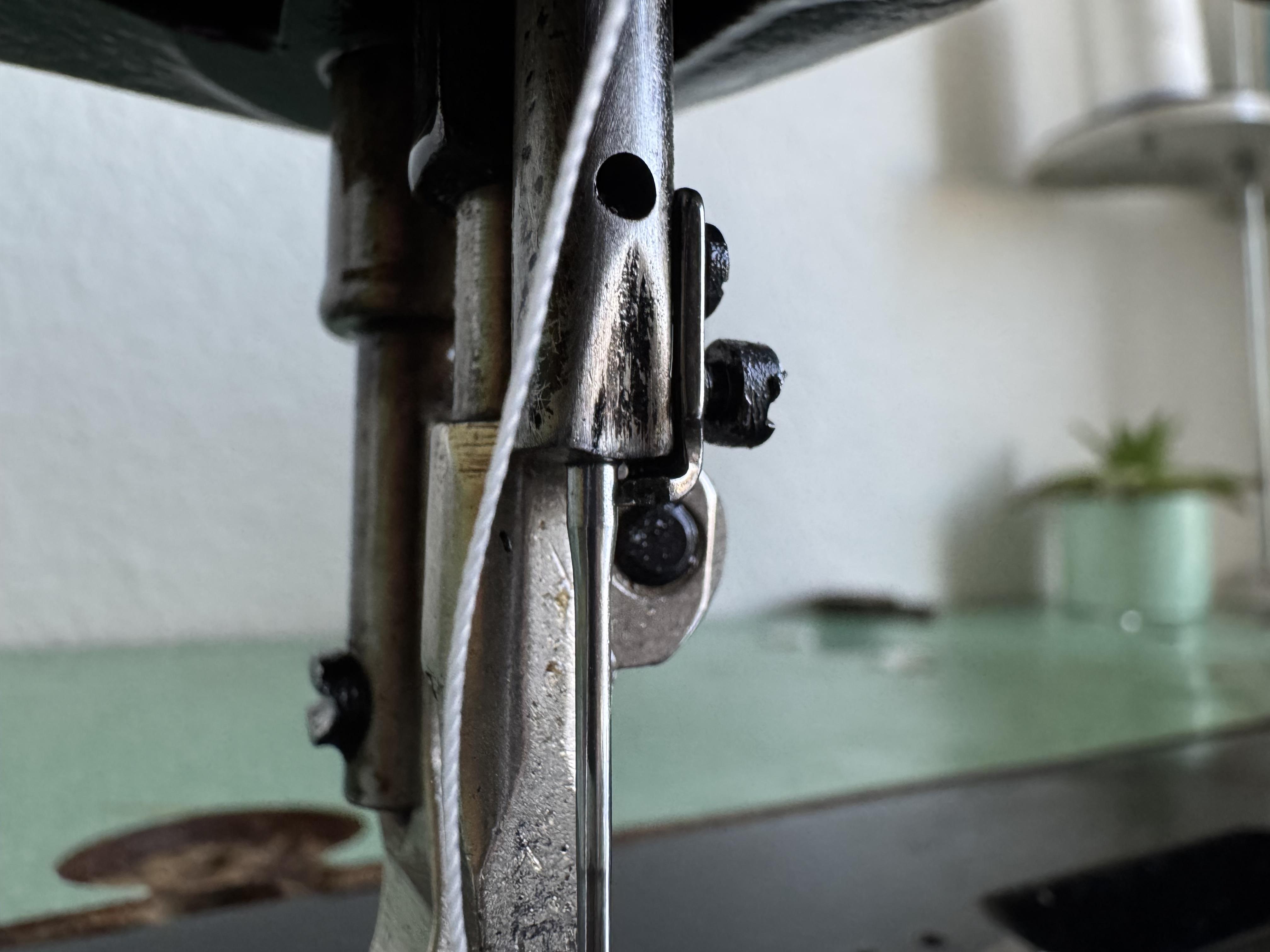

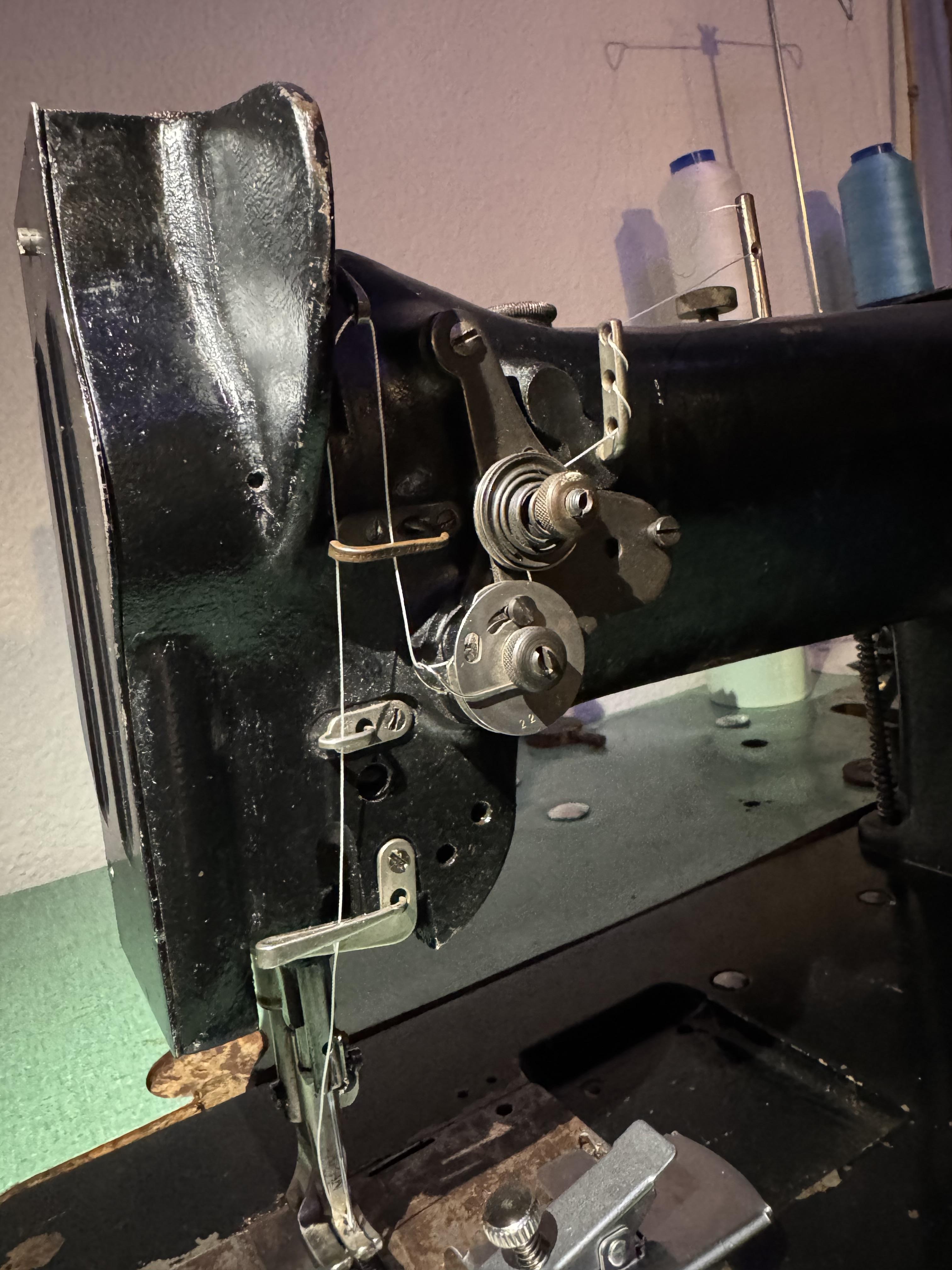

The biggest issue going on is the top thread is not being pulled up all the way to form a tight stitch...rather, the loops of top thread are hanging free on the bottom. As kgg said, tighten the top thread tensioner, and if that does not clear it up, post photos of your top thread path so we can see if it is threaded correctly. The other issue is that it is skipping stitches. Here you will want to make friends with the service manual so you can set the hook to needle distance, the needle bar height, and the needle bar rise.
Not exactly the style I would build . . . but from what I could tell . . . the craftsmanship looks good . . . the dye job looks very even . . . and that is a cute little tie thingy in the center front to set it off. All in all probably would sell on the uptown market . . . You did a good job. May God bless, Dwight
I would suggest taking a couple of photo's showing your top threading from the spool of thread to the eye of the needle. I figure it is incorrect threading of the top thread or a top thread tension issue. kgg

This is on my singer 111w155. Does anybody have any idea what I might be doing wrong? Or how I might correct this from happening. Thank you so much for any feedback!
