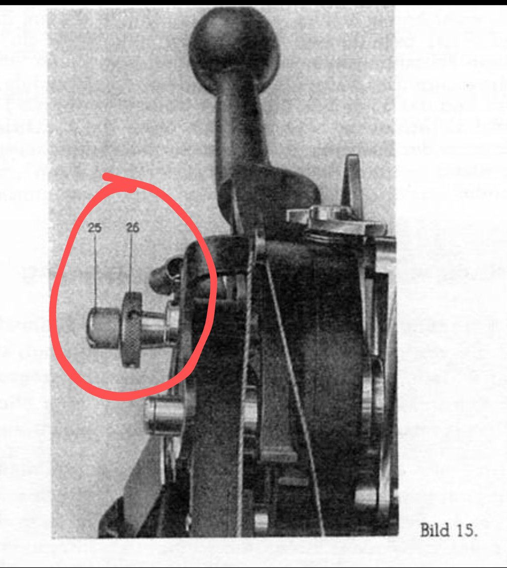

  2. Yeah, I have a few needles. I looked through Ebay and they currently don't have the parts I need. I'm sure I can make the tensioner and the plate thing myself but the screw for the stitch length is another story. If I knew the thread pitch and size, I might be able to make one on the lathe but I'm not sure. never made a screw before. I do have a machine shop near by maybe I'll go to them if I can find the info I need. thanks for the help.
  3. @Calidora I think the only place to find spare parts are on Ebay or similar sites. But just as a "warning" before you spend too much time and money hunting parts: The needles are really hard to find, and not readily available. I once checked Gross Beckert, and they'll make a production run if I ordered something like 500 needles. But if you have a couple of needles, then all is good :-) I have a machine like it at home, but I have been too busy tinkering with it. But I am pretty sure that it dodn't come with any spare parts (I am at sea right now, so I can't go check it) Brgds Jonas

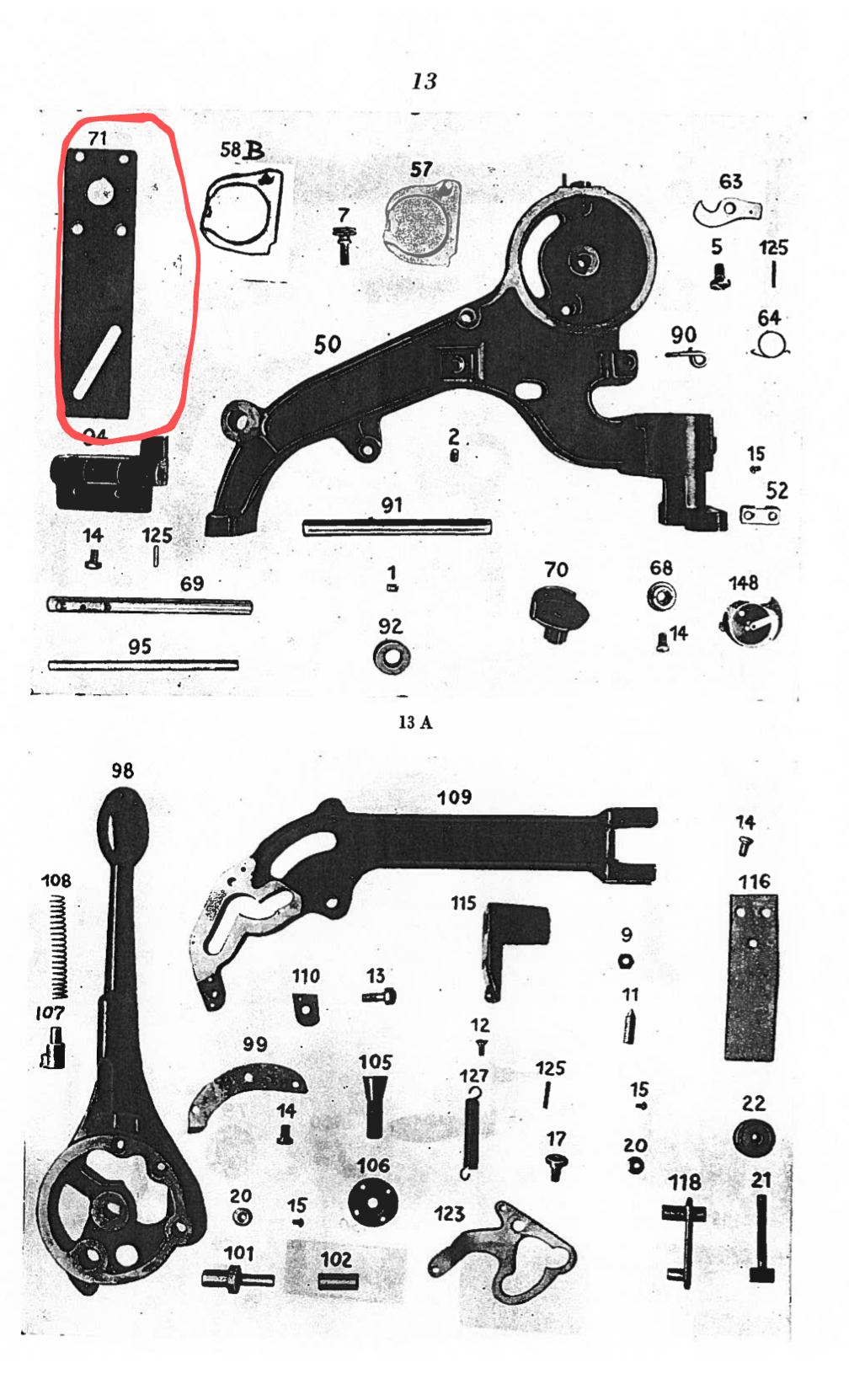

  8. I recently purchased a Pederson model 308 and noticed that it needs some parts. It's missing the entire tensioning unit and the parts circled in the images. I believe they are interchangeable with the Junker and Ruh SD28. Is there somewhere that I might find these parts or am I out of luck and will have to make them myself. Thank you for your time

  13. It does appear to have been used in a few different machines, lucky for me. I think this machine is the ancestor of the W&W D12, except the couple of pictures I can find of the D12 show a single bobbin serving both needles. This is by no means definitive, just me searching the net.
  14. Thanks for taking the time to send this along. It's quite close, a good clear copy and has an Adjusters section, which I don't have. Very helpful!

  16. The manual for this machine is very close to yours. 72w19.pdf
