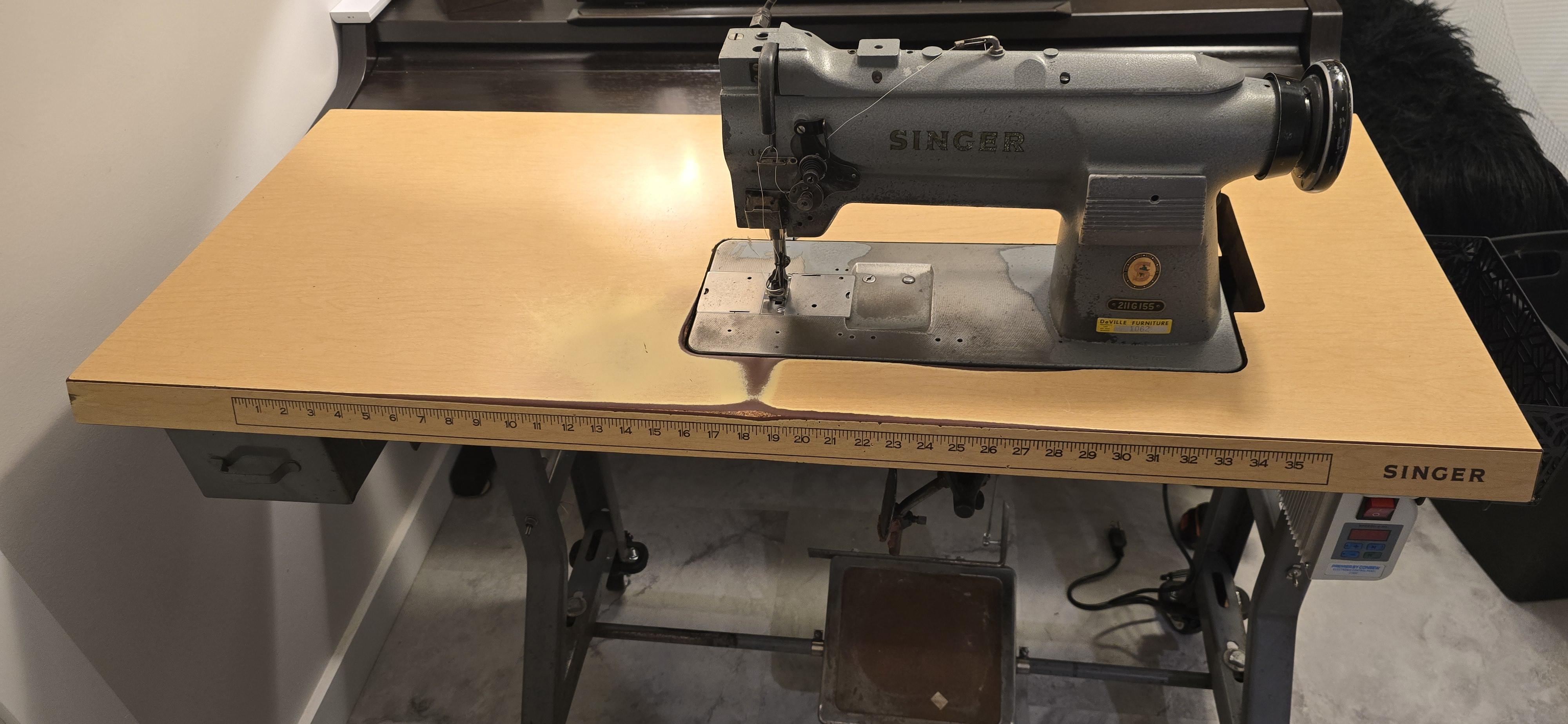

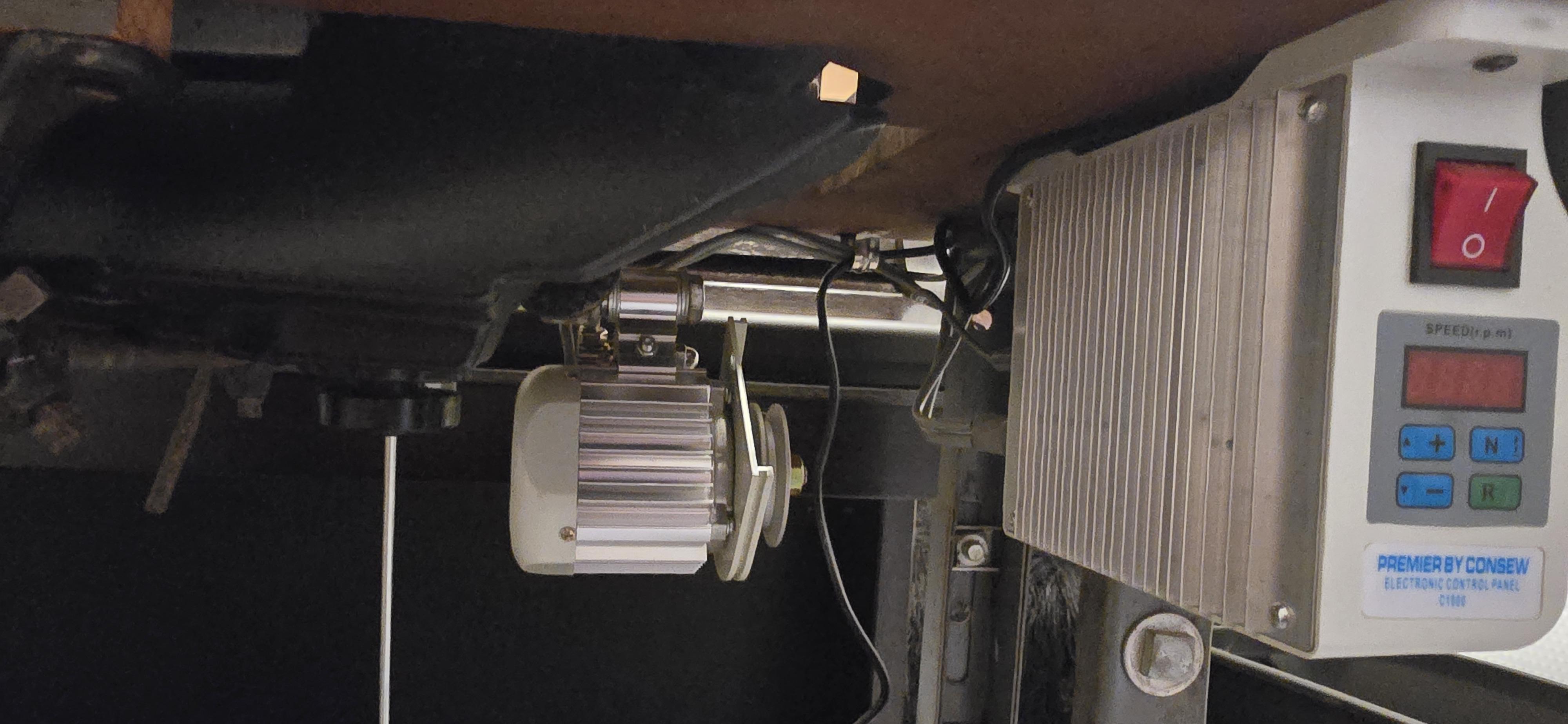

I just wanted to thank everyone that responded to my other post looking for help picking a machine. Without your advice, I might have ended up with a much more expensive machine and disappointment. Instead, I spent $200 and a several hours cleaning and swapping out the motor on this beautiful Singer 211g165. I got the servo for free from a friend that had it lying around collecting dust, so I got a great deal on that! Anyway, allow me to show off DeVille #9 (the factory it once lived in, and the number on the table). If anyone has stories to tell of theirs, helpful info and links, etc. please share!

You're on a slippery slope now. Might as well start saving up for that walking foot industrial.
