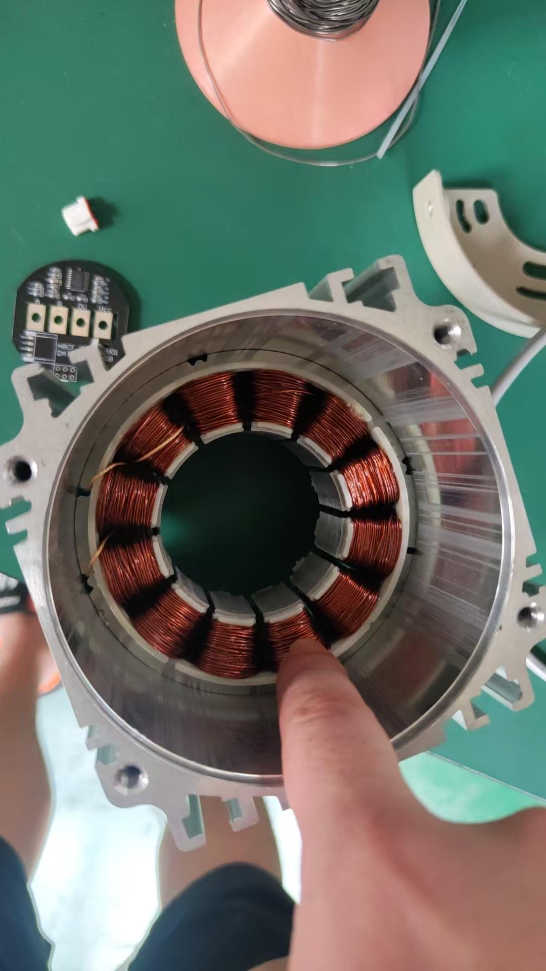

Thanks for your opinion! Before making Kinedyne servo motor, we sell other brand "servo motor" for our leather sewing machine! The fail rate of board is about 7%. We spent a lot of time and money for service after sale! Cluth motor is too bad for leather sewing machines, so we produce Kinedyne 750L economical servo motor, it is durable motor with good price, but the minimum speed is 300 RPM, customers still need to buy speed reducer! Why waste money to buy speed reducer? We developped Kinedyne HM-750SH low spee, high torque servo motor. Finally we spend less money with high performance servo motor!!

Yes, digital servo motors will lose torque at low speed, and the motor will vibrate or noise when start up, because the torque is not enough. When get change, please test Kinedyne HM-750SH sero motor from Ryan or Toledo Industrial Sewing Machine, I think you will be surprised with torque and speed control. Really appreciate for your information. Can you test 10 stitches per minitue? See if smoke came from the needle! Now we use 45mm pulley, the lowest sewing speed of CowBoy CB4500 is 10 SPM. If the needle still smoke, we will try to use smaller pulley or modify the program. And when thin leather, we have speed controller that allow you to increase speed in a second. Thanks again for your informtion about the lowest speed!

I 100% understand your opinion, but many modern standard arm sewing machines use JOG dial, for example Durkopp Adler 967, you can see the jog on some other computerized upholstery sewing machine. Ho Hsing i90 is an excellent servo motor for heavy duty industrial sewing machines, the price in China is over $500.00 USD, and about $400 USD in Europe, it is too higher for 205-370 Clone or 441 Clones. Clutch motor is very bad for leather sewing machine, we searched good servo motor for our CowBoy leather sewing machines for about 6 months, no affordable servo motor can work for us, that's why we start to produce servo motor. We has been selling servo motor in United States for about 2 years, all Tandy CowBoy 797 sewing machines come with Kinedyne HM-750SL servo motor. However we must keep innovation. Last October, our Italian dealer suggested the JOG Dial, we make it reality. Last month, our Sweden dealer suggested Half Stitch we made it reality....

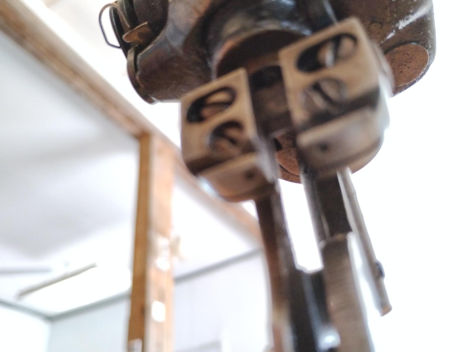

How to buy or make a finger guard for a Juki 341 clone? I occasionally see photos of triple feed machines with finger guards, but the feet I bought do not have extra mounting holes for guards.
