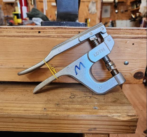

  2. A couple of years ago . . . I was in an Amish store that sells material for sewing . . . kinda like an Amish Joann Fabric shop. They had this tool in there . . . and I knew exactly what it was as soon as I saw it . . . the tool itself was 35 bucks . . . and the set of dies was 18. Both sets fo male and female came in that kit. I went back later and bought another one just like it . . . so I didn't have to swap dies every time I wanted to do a snap. I have been just plain pleased with this tool . . . it is great . . . you have to be careful and follow directions . . . and if you do . . . great snaps every time. I believe I also saw them in Hobby Lobby . . . not certain. There is a cheaper version like this . . . sells for about 18 bucks . . . comes in a kit . . . Amish buy them for the snaps for the women's clothing . . . it is a smaller tool . . . and I don't know if it will do line 24 snaps . . . mine does every time. Nothing against Dot . . . but that's a bunch of money for a snap setter. May God bless, Dwight

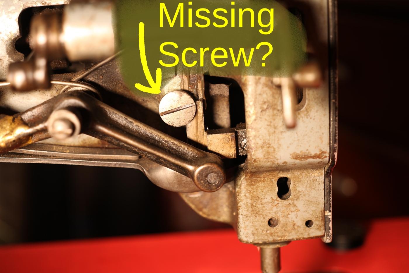

  3. It looks like you are missing a screw here.
  4. This is normal. The extra work is going into compressing the presser foot spring. The effect goes away if you lift the presser feet. Mine does not lift as far when the inner toe is down. Maybe you aren't getting enough lift. Try pressing down with your hand on the far end of the foot lift bar and see if the feet will come up.
  5. Missing lock nut? My singer 144 has a lock nut on that stud.

  11. Thank you all for your help! I ended up cheating a little bit and took the machine to a machine shop. The machinist got the screw out in minutes and didn't charge me. I asked him how he did it, and he said I had already done all the work for him 😆 I think it was likely a case of having the right selection of screwdrivers to fit the deformed slot, just like you all advised me. He also is 94 years old and probably has about 85 years of experience. What a legend! Since he didn't need to drill the screw, I still have it. I cut a new slot in the head perpendicular to the old one, cleaned the threads on the screw and on the machine side, and so far I'm reusing the screw and it seems to be fine. I got the feet lifting equally now, too. The only things that seem wrong still are: 1. Cranking the machine takes a bit more effort during the part of the cycle when the inner foot is making contact with the work and the needle is down. I don't see anything binding, it just doesn't feel as loose and smooth as the part of the cycle when the needle is up. Is that normal? 2. The pressure foot lift releasing lever (the lever you'd use to raise the feet when beginning and ending your stitch) will lift the feet when the needle is up (and the outside feet are down) but won't lift the feet when the needle is in the work and the inner foot is down. Any ideas? I think it's something with either screw A or screw B in the pics I've attached. The lifting lever isn't contacting the whole assembly it needs to lift when the needle is in the down position. THANK YOU all again for your advice and guidance. You guys rock!!

  20. Google image search says it's a Singer 7-33. https://www.google.com/search?vsrid=CMGasciNpZWkahACGAEiJDA3ZDlkMGM2LTVlMDMtNGRiYS04NThjLTA3NDMzYjljNzZhYTIGIgJnaCgKOIz6m8nV9o8D&vsint=CAIqDAoCCAcSAggKGAEgATojChYNAAAAPxUAAAA_HQAAgD8lAACAPzABEIAIGIAGJQAAgD8&udm=26&lns_mode=un&source=lns.web.gisbubb&vsdim=1024,768&gsessionid=24dj2mh4nfiLTSphHqJfHudhqACKQKBxlDVm2yspEKbM25XhmrRn0A&lsessionid=U9iFFpQDbhz8KncIZ7XjX8c_1DDP_O5CbKsLDwO4GzJa1yPHkLRbRA&lns_surface=26&authuser=0&lns_vfs=e&qsubts=1758897977399&biw=1920&bih=903&hl=en#vhid=v6WRbHUhptf8PM&vssid=mosaic Here's the pdf for it. The 7-31 is similar to the 7-33 and uses the same manual. http://hensewfiles.com/PDFs/SINGER 7-31.pdf

  23. I've been asked to come look at this machine. They say they think it is "out of time". I can time almost anything, if that is the problem. Can anyone tell me the model? Any suggestions or resources? Thanks!
