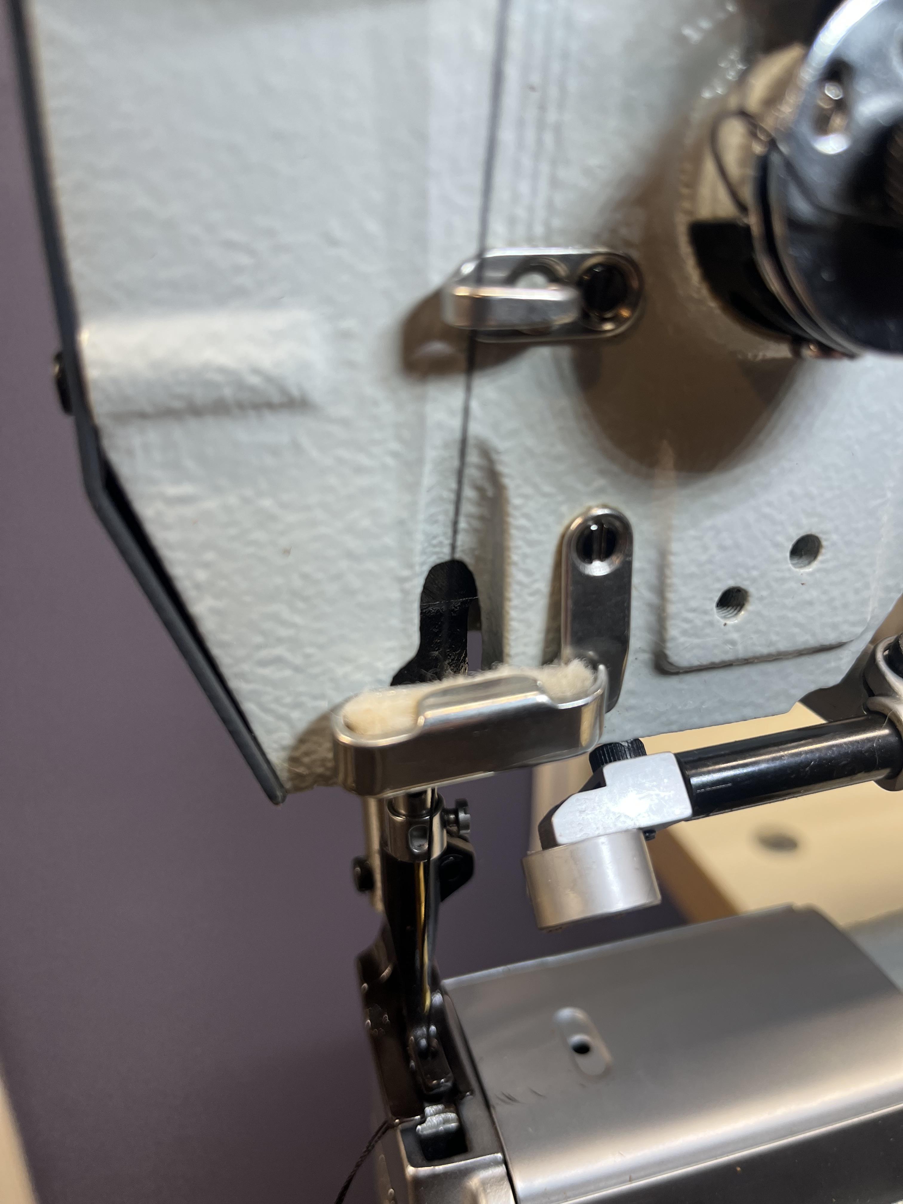

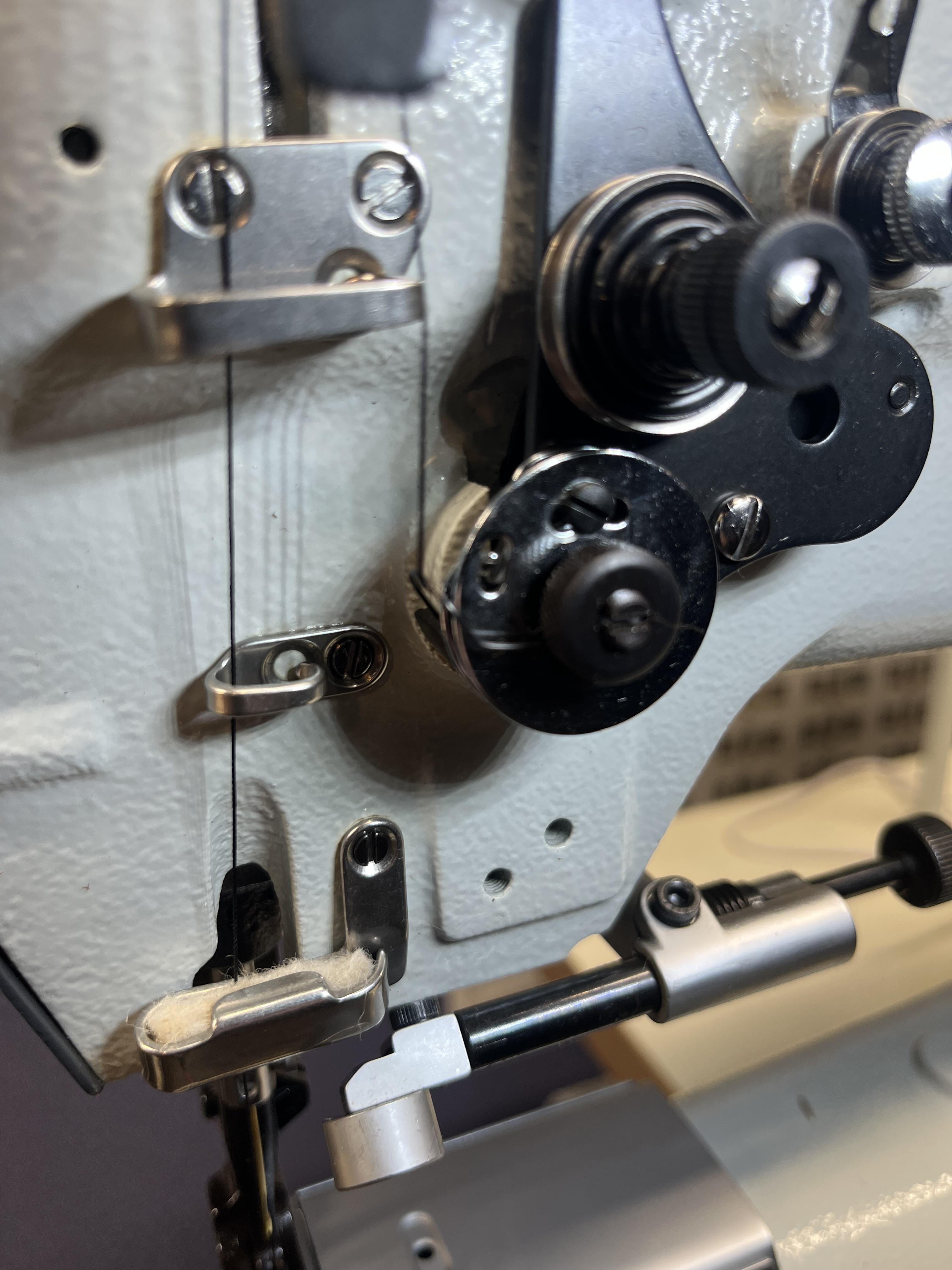

Here’s a video of it happening. IMG_6701.mov
My thread keeps jumping out of this tension spring. Do I need to rotate it down to keep the thread in? Also do I remove this wool like material from this thread guide? thanksr tj
