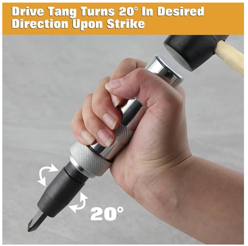

friquant replied to matthew123's topic in Leather Sewing Machines
As for removing the screw with the mangled head, has anybody tried an impact screwdriver on their sewing machines? https://www.amazon.com/LEONTOOL-Extractor-Reversible-Screwdriver-Fasteners/dp/B0CTXD91YW -
