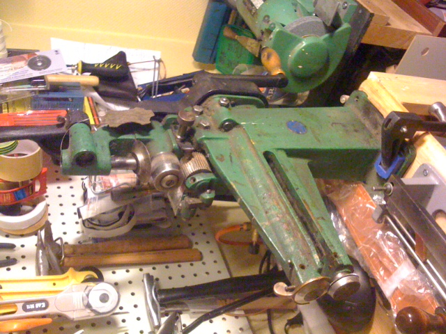

Some more angles, or the wrong angles. I am using a friends laptop with Linux OS, I cannot get the pictures to turn the right way. They are saved the right way on the laptop, however, when I upload them they lay down on their lazy side. Strange! I give up. Please turn your head or PC to look at them. If somebody (who is located not to far away from me, Oslo Norway) needs a machine like this I can part with one of them, for a reasonable price. Thanks Trox

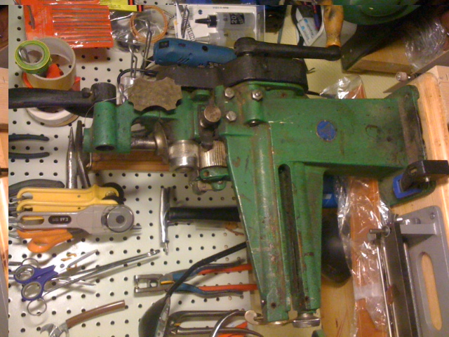

Hi All, I have two old 5 in 1 combination splitting and cutting machines. The splitting and skiving function works on both of them, the cutting function however, don't work on any of them. They both need new roller knives and maybe the under roller to. I do not know the name of this part, but it is the wheel the roller knives cut on. Both machines look alike, but one is painted red and the maker name is not visible. Do anybody know where I can get new knifes and rollers for these machines? I have seen guides attached on these so they can be used as strap cutters, I never tried to use them for that. Do they work well for cutting straps? In advance thanks for any replays and help. Trox
