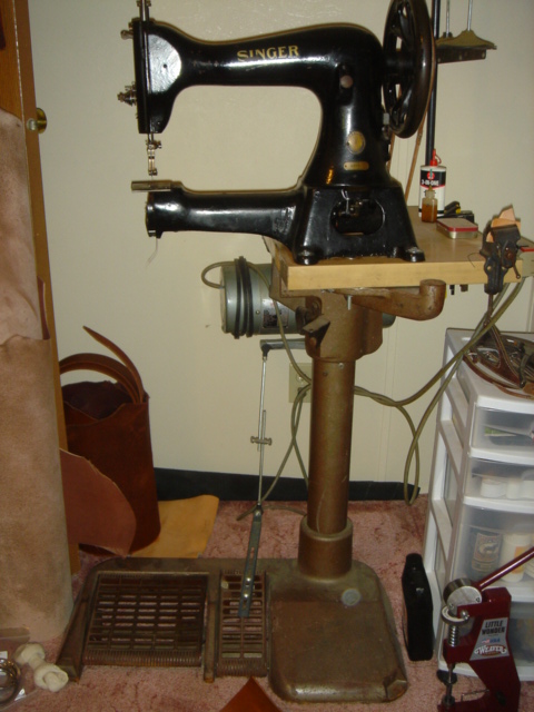

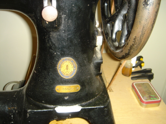

Ok, I had this for sale a while back and had it "sold". Anyway it's still for sale (again) . It's 45K25 Singer, s/n EG210092. It's a bottom feed only. I put a new shuttle in it and it's sewing good. It comes with the thread stand, extra bobbins, extra needles, bobbins, the table and motor. I also have a parts and operators manuals for it. It has 1/2" presser foot lift. It sews lighter leather really well, like chaps, vests and saddle bags. If you're sewing heavy stuff, you probably don't want this machine. I have done headstalls with it, but that's about all it wants to handle. It would make a good machine for someone getting started. This thing weighs quite a bit. So you can pick it up, or I can ship it. Truck freight only. I'm asking $ 600.00. Will consider offers. E-mail me with any questions or call 402-389-2008.
