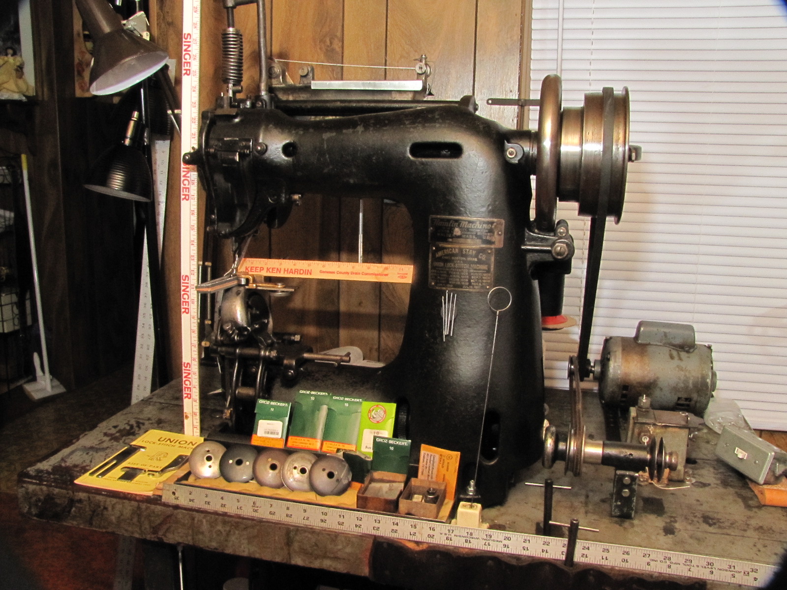

  14. Call the dealers listed in ads on top of each forum page and ask what they can do for you. Alternately, or if no happy happy, see the Machinery > Sewing Machines > Used section of Marketplace for second hand triple feed 441 type machines. The heavy waxed thread from Tandy is #554, which is not sew-able on most eye-needle machines. It can however be used on a Union Lockstitch machine, with a #4 or #5 needle and a #5 or #6 awl. I have some of this thread, by my needles and awls are too small, number-wise. I've been thinking about getting a few larger needles and awls so I can experiment with this thread (which I have in 3 different colors). My machine uses a barbed needle, just like the hand stitching awl you may be using. For a little more than you plan to spend, you could buy my ULS machine off me!
