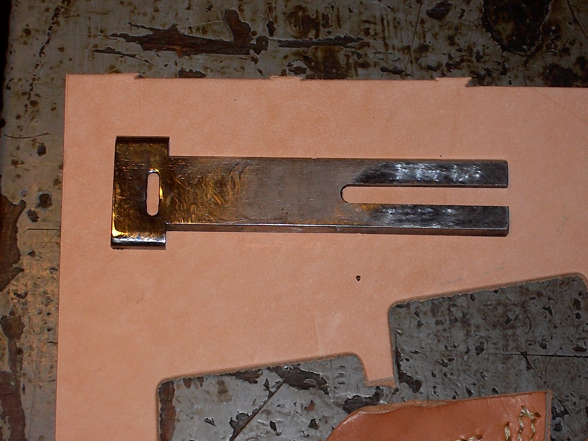

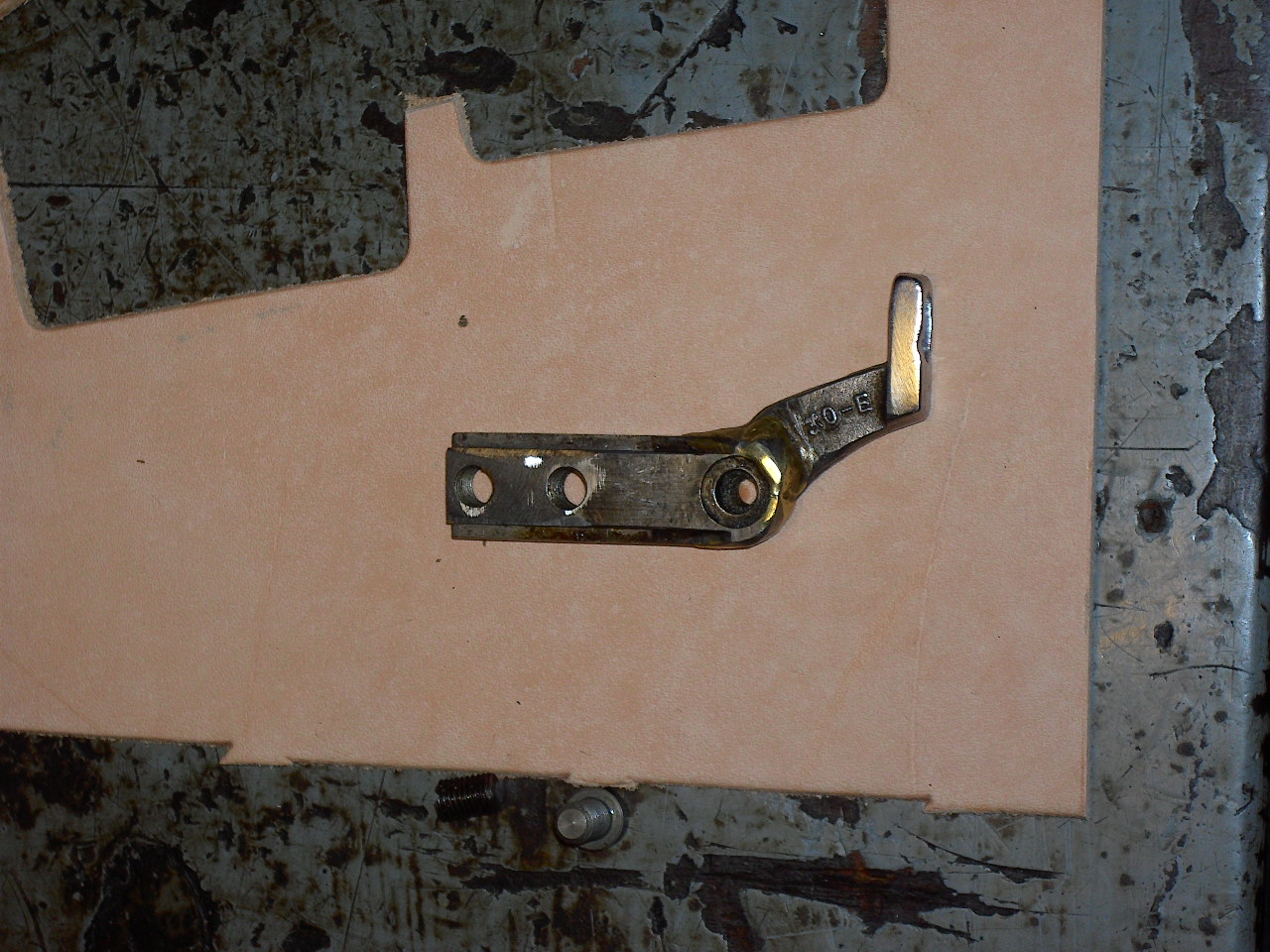

Andrew; Things are moving along not too badly, considering where I live. I just built a holster for an 8" bbl Dan Wesson .45 LC revolver, with bullet loops sewn on the front, on my (your ex) ULS machine. The ULS has no trouble at all penetrating 4 layers of 8+ ounce veg-tan leather. I use #277 bonded nylon most of the time, but occasionally, #346 polyester. If you do buy a Campbell Randall, get some #346 bonded polyester thread with it and various sizes of needles and awls, plus lots of bobbins. If you opt to buy linen thread, I recommend 4 and 5 cord Barbour's Irish Linen, left twist, and a gallon of Lax Wax. The cheaper Hungarian linen thread is not as well smoothed and bonded and has lots of loose "hairs." It's too bad we live so far apart. If we were in the same area we could split the cost and use of a Randall! I understand that Dan sells them fully rebuilt for under a gazillion dollars!
The Union Lockstitch you traded to me does all that too. There are pressor feet and throat plates for round reins, raised work (holsters, stirrups, buckles, snaps), beaded line steppers and even a stitch in the ditch set. There is even a special foot used by Wilson to sew footballs. You should have held onto it! I agree though; it would be nice to own a Campbell Randall! Nothing sews holsters, straps or harness like a Randall. I had my chance when Sam Friedman offered to sell me one of his. If only ...
