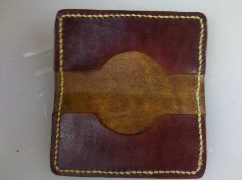

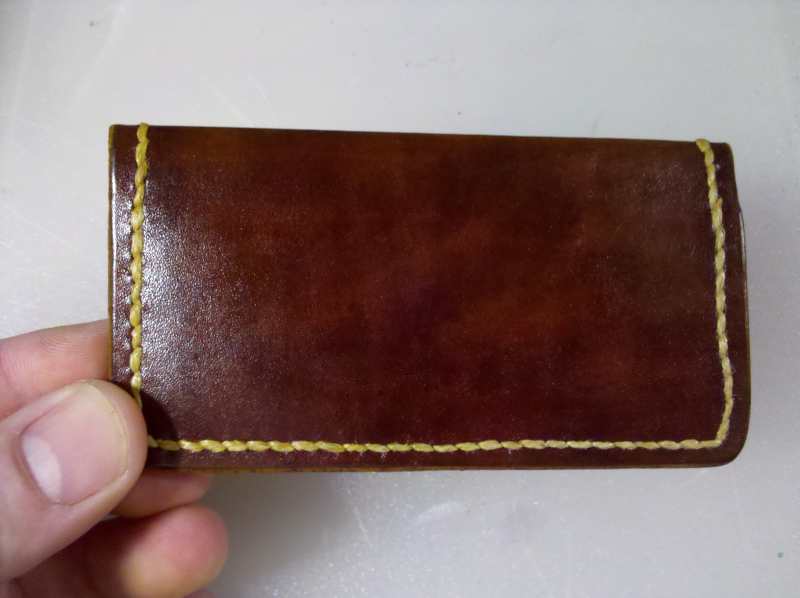

Business Card Case
RobDude30 posted a topic in Purses, Wallets, Belts and Miscellaneous Pocket Items
The pictures are terrible. Makes the stitching look more wavy than it really is. Case is made of 3-4 oz. cow. Stitched with hemp thread that I hand waxed with beeswax. Dyed with Fiebings light brown and finished with Resolene and a Kiwi Neutral polish. The hemp turned a little yellow for some reason. Probably a little dye rub off during the finishing process. -
