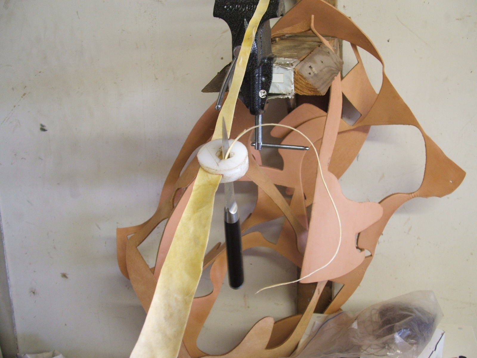

Here I have started the lace and it is coming out the top. I have pulled on the lace to get it to this point but I had to let go to take the picture.

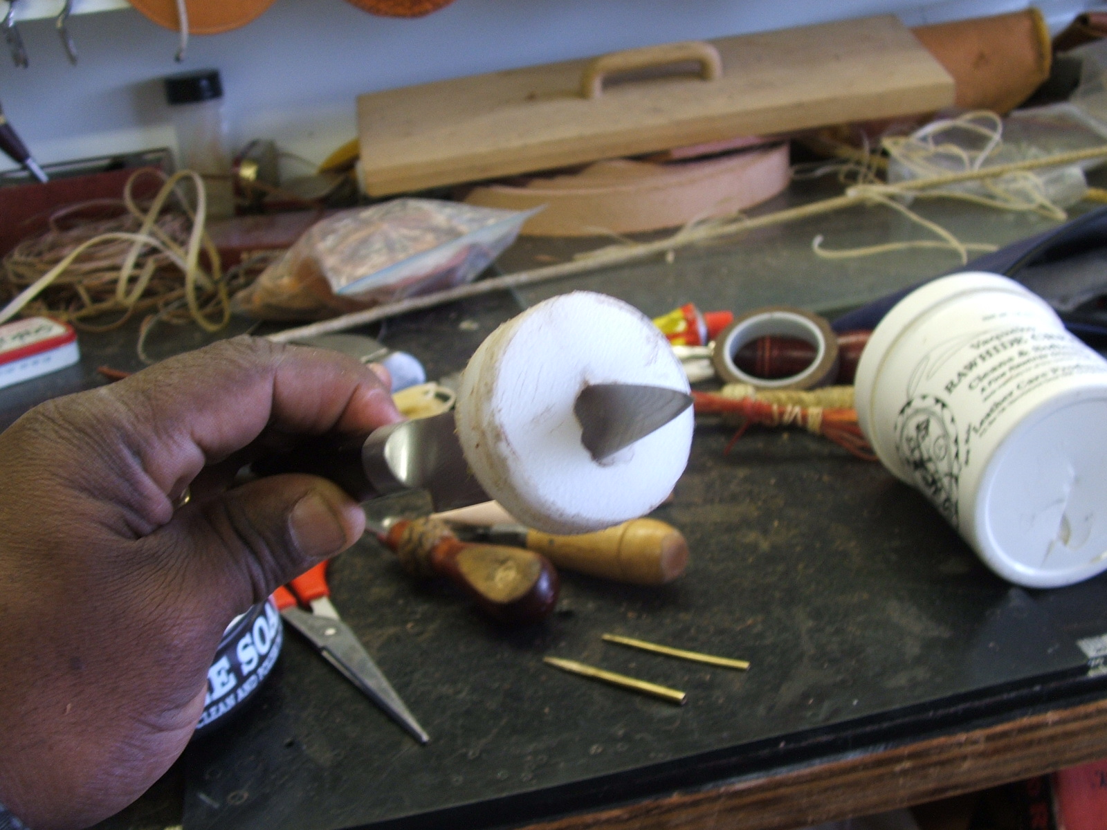

The Argentines are really advanced in their rawhide work. 60, 70, 80, and even 90 strands will be used to cover a knife handle! I've seen a braiding masterpiece of a one foot wide girth strap that took its braider, Pablo Lozano, one year to braid! They do many intricate patterns and knots far beyond our simple pineapple and herring bone. There really is no comparison yet they use very simple tools to do all this intricate work. One of these tools is their lace cutter. It is simply a 1 1/2" - 2" disc about 1/2" thick. Sometimes these are plastic washers and they make them out of hardwood or cattle horns. They cut a horizontal slit into the side that goes past the half way mark and in the middle they will drill an egg shaped hole. A very sharp knife will be wedged into the hole and the material to be cut will be slid into the slit. The difference between the keen edge of the knife and the wall of the slit is the width of lace that will be cut. Now comes the neat part...after the first little starter cut has been made you get the cut lace piece coming out of the top of the center hole, pulling the material tight (I clamp one end and pull tight with my left hand) you grab the lace with your right hand and pull towards yourself at an away angle. As you pull the knife will be hanging there in mid air wedged inside the egg shaped hole and it will just glide along as if it is cutting the lace by itself! Because of the size of the pics I made I'll have to do several post. The first is my knife inside the plastic circle.

Thought I'd put up some photos of the things I use to braid and make string. From top to bottom; left to right rolling board, pliers, hammer, cement, leather strips(for collars) calipers, rawhide lace, ruler, more leather strips, Quirt, roll paper tape, saddle soap, scissors, knife, fid, rawhide lace, another fid, more leather collars, pliers, rawhide lace Vaquero Cream, life eye needles, side cutters and a burnishing stick My humidor Vaya Con Dios, Alan Bell Bob Marley - Top Ranking

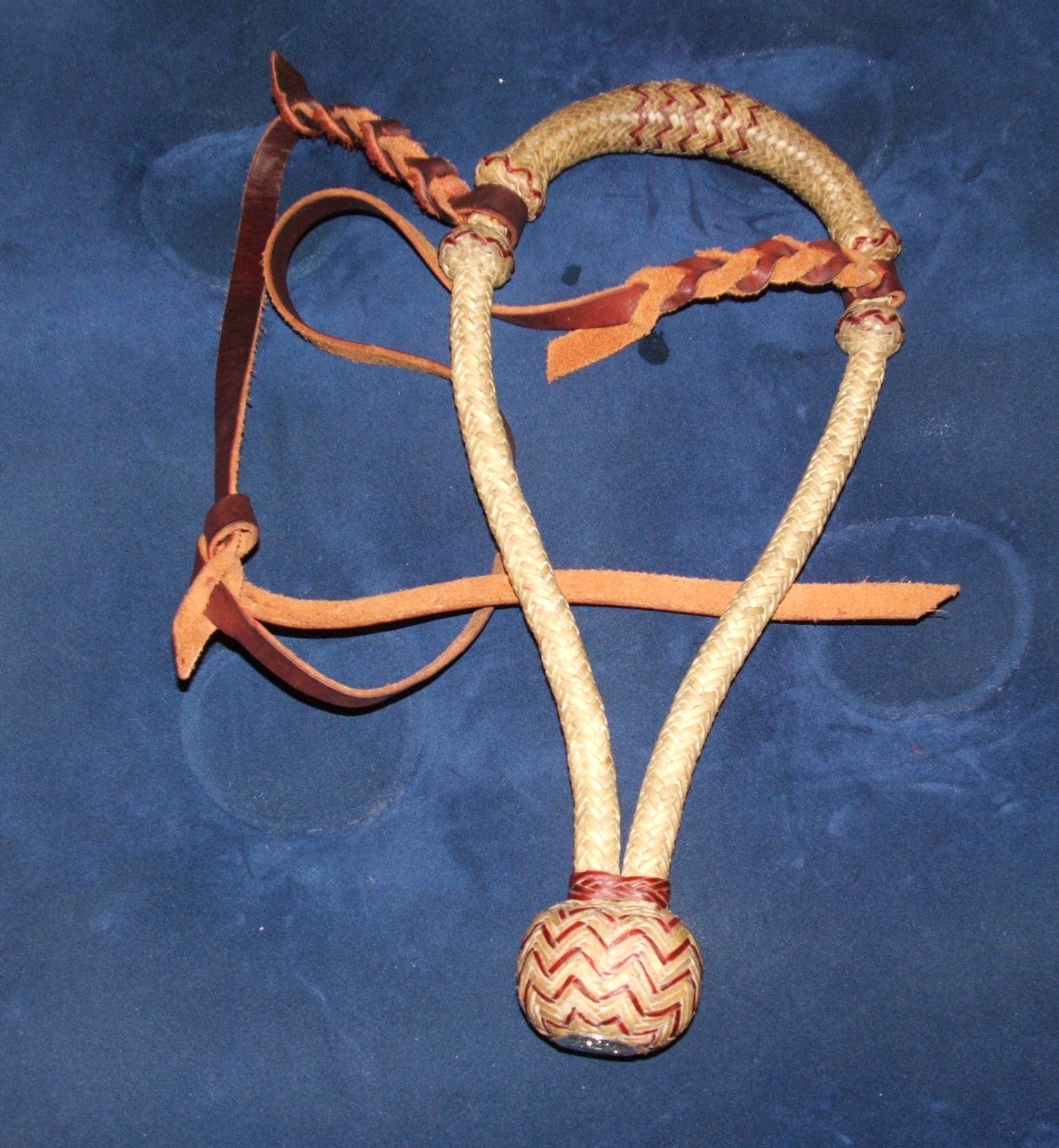

Not exactly sure what you mean by how I did the interweave but this was one of my first bosals. Actually no. 2 I think and the other one was a pencil bosal that was close but not quite! I did the interweave on this heelknot by first doing what represents the two outside lines and after seeing I could fill more space I added the middle interweave. Moisture content is the trickiest thing in braiding. My method is to wet the strings for 15 sec. or so depending on size and then pat off excess and place in plastic bag in side another plastic bag to set. Half way thorough the casing I will wipe each strand with Vaquero Cream or something similar. Then I will braid what ever I am braiding. I used to have spray bottle to re moisten the braid but now I will take either a barbers shaving brush cut down to about an inch and a half or a fairly damp cloth and rub the cream and then the braiding project to re-moisten so I am not moistening with water but with the cream. For the finer strings on buttons i may just run the string through my mouth to moisten. Saliva penetrates the lighter strings pretty evenly and it is a method that has been used probably longer than any other! I have been known to put braiding in my mouth to moisten and I know it sounds strange but it is a very good way to get even moisture into your project. Not sure why but it penetrated evenly unlike water that has to be gradually absorbed to even out. I'd rather my strings be too dry than too wet for braiding. I want them to flex enough to shape around the project and to lay flat enough for the layers in braiding but I don't want the too moist so that they stretch when braiding or the fibers break taking the strength and the life out of the strings. Also if they are too moist then as they dry they will shrink and pull away from each other leaving gaps in your work. Vaya Con Dios, Alan Bell Bob Marley - One Love
