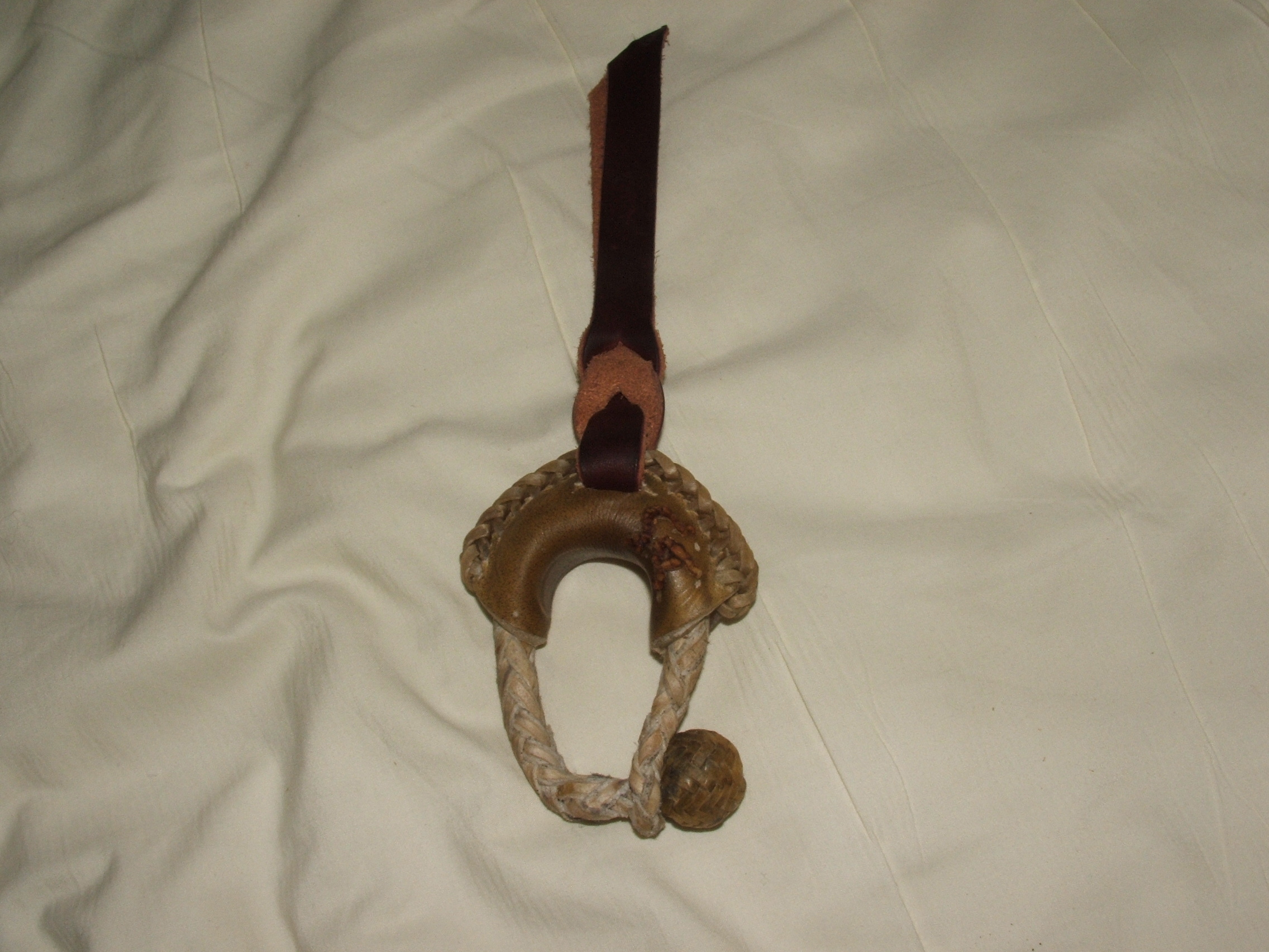

Tom, a Honda is what goes on the end of a reata or lariat. It is the eye the tail of the rope goes through to make a loop. These are just different variations that are removable. Vaya Con Dios, Alan Bell
Here's on style I make. The files are too large to send together so I'll send the other style next. Vaya Con Dios, Alan Bell
