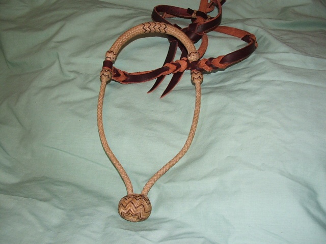

Just finished a bosalito and a 3/8" bosal for some folks. The bosalito is already shaped a little and has horse rawhide for the interweaves. The 3/8" bosal has an Argentine knot called a "left hand" ring knot that is an enlarged casa and an interweave to make that size of a knot. It's a tricky knot to tie. Someday I'll try and post a tutorial on it. Vaya Con Dios, AlanBell bob Marley- Keep on Moving!
