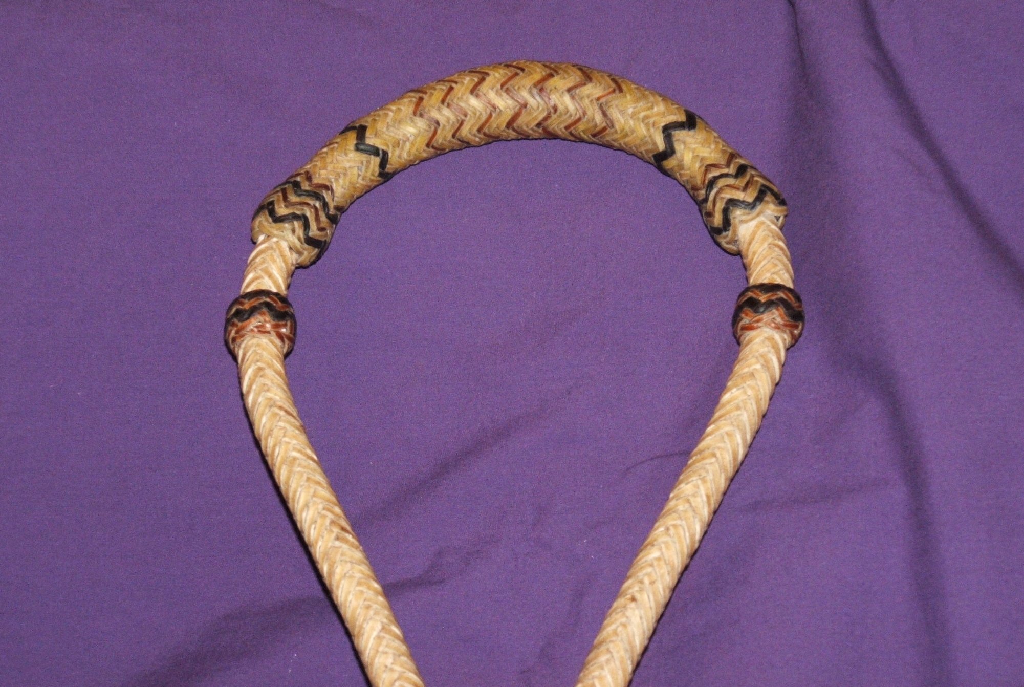

TwoCrow, Very good job on your interweave! You built a nice base or casa and then added the first interweave in and the second without distorting the first! If you keep doing that quality work you've got it made! I'm not at home so I don't have an pics of the tools I've done but I do have a pic of a noseband i did with different interweaves. Vaya Con Dios, Alan Bell B0b Marley - Pass it on!
