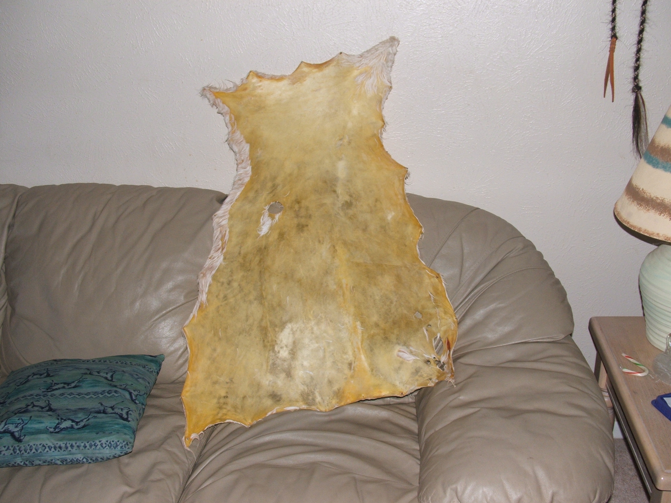

Horse rawhide is thinner than most cow rawhide. The string is mostly used in Argentine type horse tack like bridles and quirts. Then also cover their traditional knife handles with it. It is pretty uniform in thickness and you don't have to split it to even it. You only use the hide running in a triangle from the bottom of the ear to the croup on each side of the horse and a triangle running from the throat to sex organs. The belly hide is even finer. Sometimes you can take the rump for a thicker piece. The Argentines also make a boot from the skin basically from the hock to the rear fetlock. Vaya Con Dios, Alan Bell Bob Marley - Duppy ConquerorHorse belly rawhide
