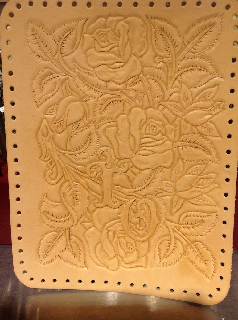

  17. I completed the tooling on an ereader cover for someone very near and dear to me. This has to be the most tooling I have done for one piece.
