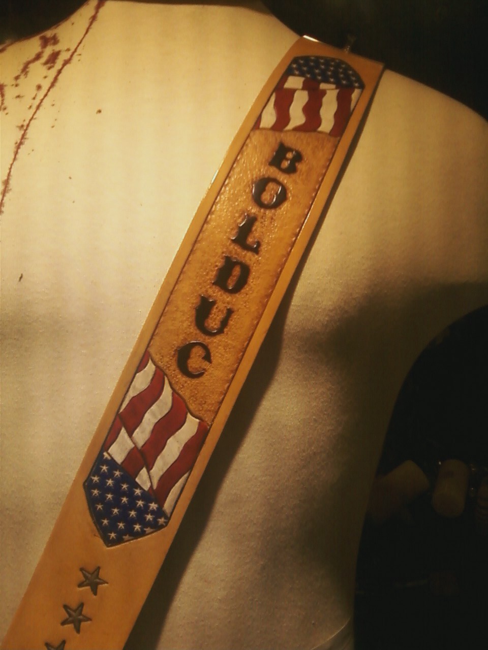

For me I paint, antique then finish. For example in this guitar strap, I dyed everything I wanted to dye, then painted everything I wanted painted, then used Fiebings paste for antique and then leather sheen for finish. The letters are actually colored with a black sharpie...better control in my opinion. -

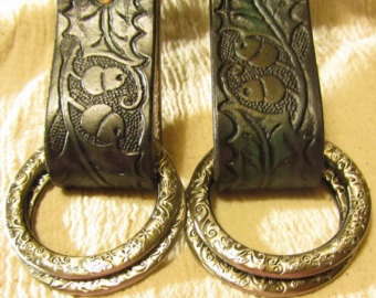

I am looking for some decorative rings like the ones in this picture. I've searched the web to no avail. Antik corp has some different styles, but nothing like this. Any help would be most appreciated.
