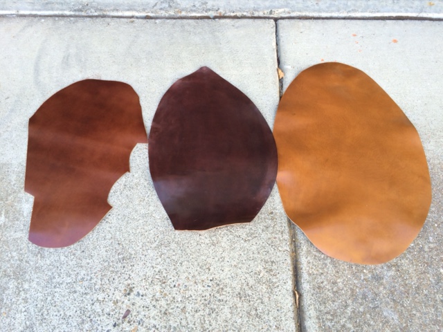

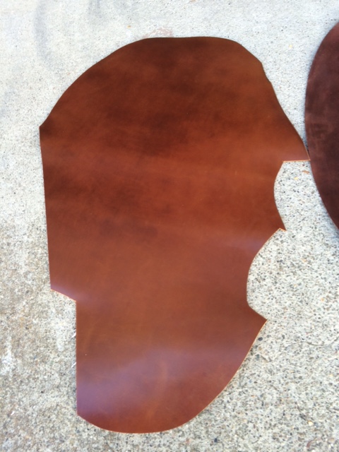

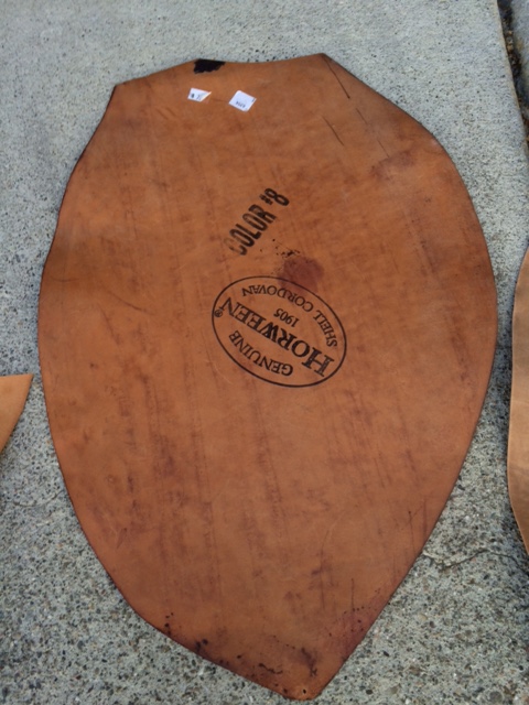

Hello all. Just figured that some folks here might be interested in a photo comparison between Horween, Clayton, and Shinki shell cordovan. I recently have been able to purchase a bit of each to compare. As you will see in the pictures below, the darkest one is the Horween shell. The middle brown is the shinki, and the tan one is a Clayton. They are all around 3-4oz in thickness. Horween is the most expensive by far, almost twice as expensive as the other two. In terms feel, Clayton's is a little bit softer than the Horween but comes closest in terms of touch on the front and back side. The back side of the Shinki is rougher kinda like if they put the shell through a splitter (although the fact that the shell runs from 3-4oz makes me think they didn't). If you were looking for something that most closely resembles Horween shells then the Claytons will come the closest. The Shinki is nice but has a slightly firmer feel with a slightly rougher backside. They are all very nice shells and pretty similar to each other but those are the differences that I can tell.Of course neither the Clayton nor the Shinki give you the nice "Horween" stamp on the back that people look for... The Horween shells have to be purchased from Horween. The Claytons can be purchased from Booth and Co in Peabody Mass. The Shinki I won't say cause the people selling it didn't really seem like they wanted to sell them so they probably wouldn't appreciate a bunch of people ordering it.

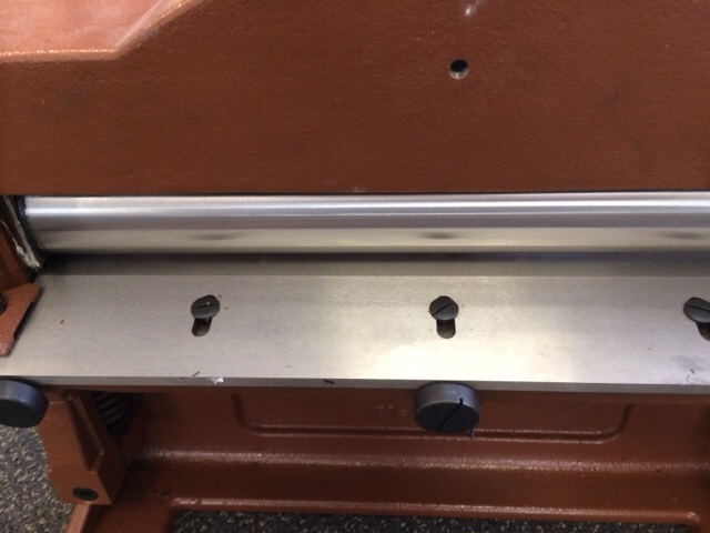

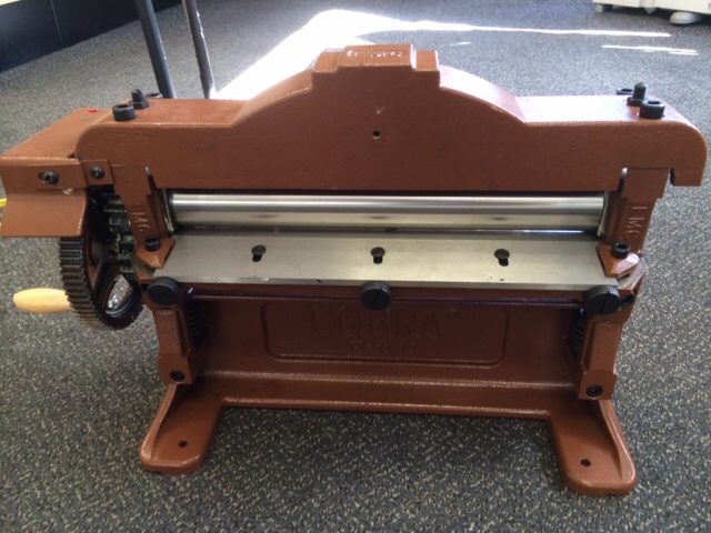

Hello all, I have a like new Cobra leather splitter. I purchased it new a few months back and it has been lightly used. Works perfectly. Condition is like new. I don't have much of a use for it now so I'm selling it. This is the head only unit so it is hand cranked. New the head only is $1950. I am selling mine for $1700. I would prefer a local (San Francisco Bay Area) transaction but will ship. US shipping from UPS with insurance and everything would be in the $150-200 range depending on where you are. Thanks. Andrew

The blade width is 6" but the effective width is probably 5-1/2" to 5-3/4" not exactly sure. I'll look into shipping and packing and let you know. Andrew

This splitter is still for sale. I am now willing to ship it if you pay for packing and shipping (it would be whatever UPS charges for packing, insuring, and shipping). Thanks. Andrew
