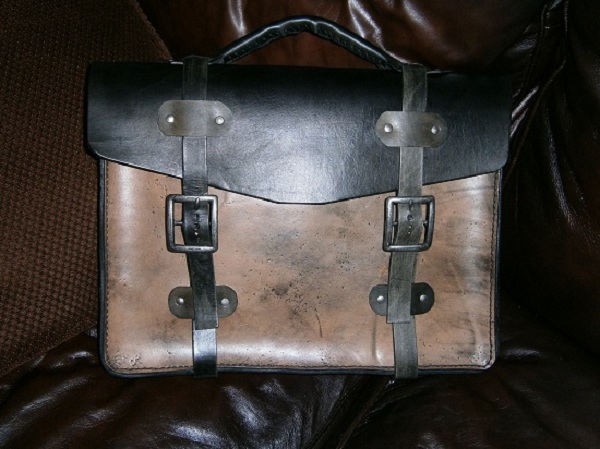

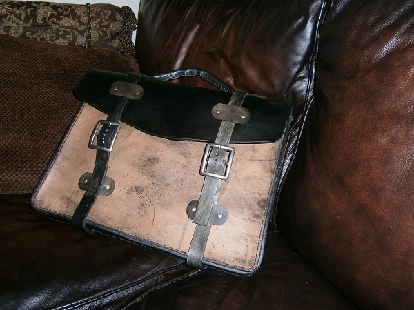

  2. Last fall I did my first entirely from scratch project using the Dispatch Rider briefcase pattern Tandy has up in leathercraftlibrary.com and it came out okay, but lots of things about it I wasn't happy with. Thought it was a good learning experience though and was planning to do another in a few weeks to see if I could improve upon it now that I'd made it once. But I ordered this kit when it came on sale the other night. It's basically the dispatch rider bag updated and modernized, and I really want to see where and how exactly they've changed the design. I mostly want to use it to make templates off the pieces and use it as another learning experience. I do have Stohlman's case books and had considered trying to use what I've learned from them to lay out a briefcase design of my own, but I'd be lying if I said I'd rather do that than just try making adjustments to an existing pattern. I'm sure this kit will have all the usual shortfalls of Tandy's kits - crap leather, large holes, etc - but for me looking at it as a physical lesson in design & pattern making instead of as just a briefcase, the price they want for it is acceptable.
