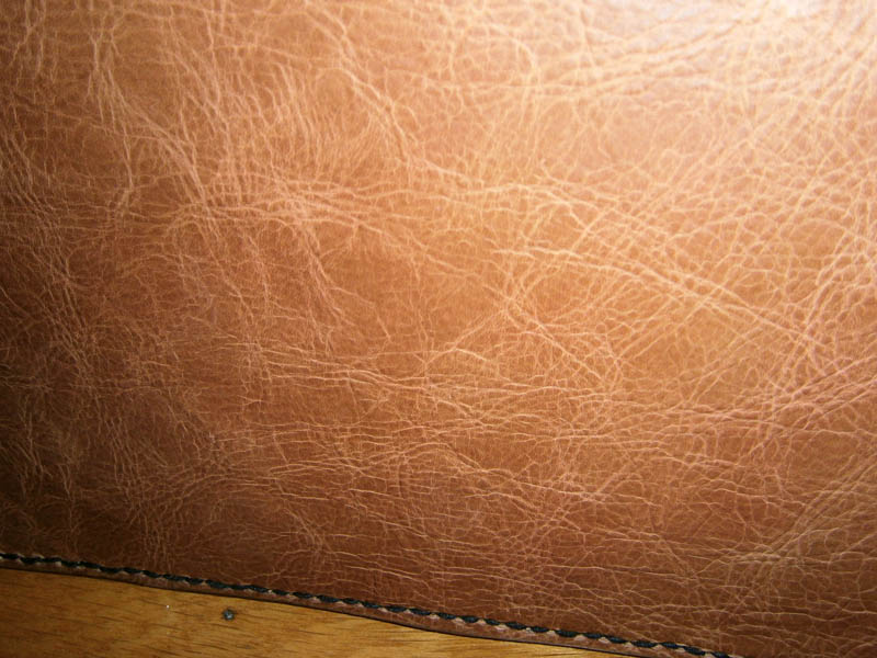

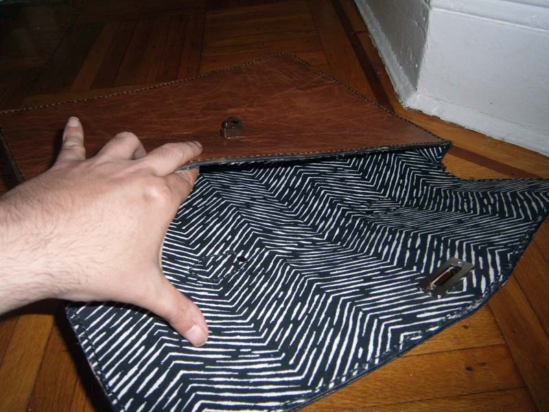

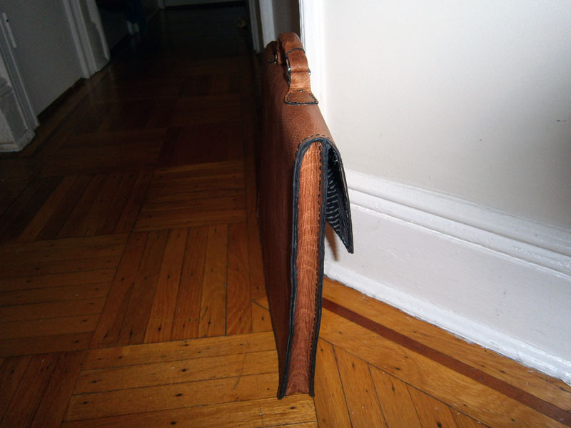

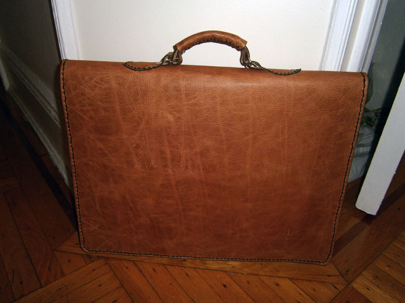

Pretty basic. Based off the pattern for Tandy's old Dispatch Rider briefcase, but I've changed the handle and removed the strap closures and replaced them with a clasp. Leather is a kamali pull up leather I bought from springfield leather a year ago, over a layer of bontex as stiffener. Case is fully lined with a black and white canvas fabric. The first briefcase I made ( http://leatherworker.net/forum/index.php?showtopic=42919&hl=dispatch ) I punched the holes with a rotary punch. This time I used an awl, though clearly I have a ways to go with getting better at it.
