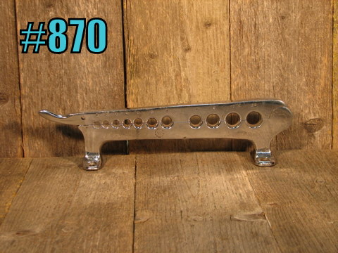

  10. Right now I have 8 ready to go. There is a Dixon, some Blanchards, and a couple Mayer-Flamerys. Here's a link to the page with them - Plough Gauges
  11. Dixon and Vergez- Blanchard both still make them. I haven't heard if anyone in North America is selling the Vergez-Blanchard line anymore. Vergez-Blanchard has a website in French. For Dixons, Booth and Co in Massachusetts looks to be the lone NA source and Abbey Saddlery in England is another source. It looks like you might be able to buy directly from Dixon too.
