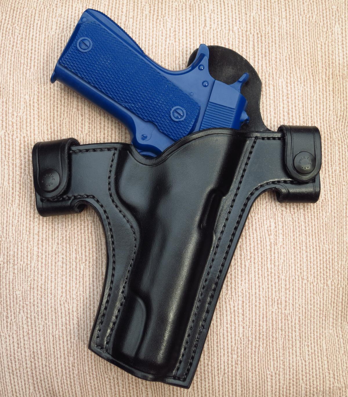

Some Recent Holster Work
SooperJake replied to SooperJake's topic in Gun Holsters, Rifle Slings and Knife Sheathes
I used a stitching chisel, believe it or not. I have a 4 prong and a 2 prong but I bought 2 four pongs and sawed the outside two teeth off of one The spacing where much more exact that way. I also stoned and polished them to both sharpen and reduce the size. The holes close up just about as good as a regular awl. I really sucked at using the wiz wheel/awl method. I kept missing the groove in the back, which looks much worse than no groove at all. Just like machine sewing. By the way, if you are using an awl, a wine cork on the back side of the holster will really save your fingers.. Plus, no more stabbing my fingers. : ) If you go the chisel route, dip them in wax for ever punch, and make sure you keep them perpendicular to the surface. Also, watch them you don't bend any teeth. Thinning them from sharpening they want to bend easily. Tap, tap, tap. Not WHACK. Make sure your thread is properly waxed. Some of the guys here in the forum are WAY better at hand stitching than I am. And they are happy to offer advice. Take it. Many decades produces mastery. I got impatient and bought a stitcher -
Thanks for the compliments. It was stitched on a Cowboy CB4500 with 277 thread (top and bottom) and a #25 needle. The finish is Angelus 620 (matte) cut about 50% with water and shot from an airbrush. 3 coats. I let it cure for almost a week (was humid at the time) and then I used Renaissance wax polish on the top. Sometimes the Angelus stays kind of tacky, and the wax takes care of that, without leaving fingerprints or excess shine. Come to think of it, I think I used 600 on the slot holster and the mag carrier with the bullfrog band at the top. Either way I cut them with distilled water for use in the airbrush. One thing I have noticed with airbrushing is it tends to lay the finish on in such a way as to reflect less light e.g. it doesn't really lay on as smoothly as you might think. Could just be the quirks of my gun. Anyway, I like finishes with medium to satin sheen best. -
