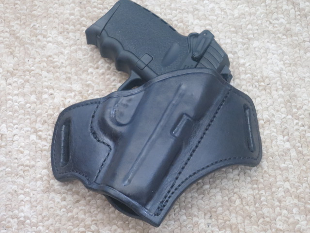

I am wondering if there is a way to lower or prevent excessive wrinkling on the compression side of a pancake holster around the belt slots. This holster is 7oz dyed with pro oil Fiebing's black. Glued and sewn flat, then molded. I conditioned it ( Bick 4) after molding and drying, then put some tan kote on for a quick finish. If gluing it on a curve would reduce the wrinkles, would I then want to use the elevated holster-type foot on the Cowboy to stitch? Right now I have the standard plate and the table attached, but the table is higher than the foot by a little. The table cannot be mounted any lower without modification, as it is bottomed out on the casting of the arm. Holster picture tells all.

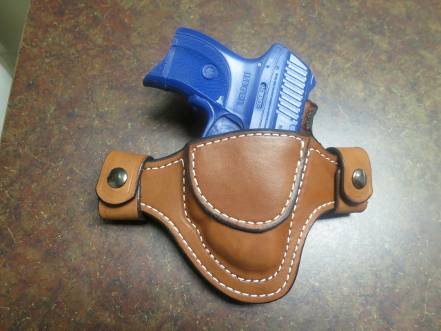

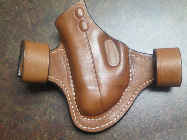

Two Birds With One Stone.
SooperJake replied to SooperJake's topic in Gun Holsters, Rifle Slings and Knife Sheathes
Interesting observation. the wing design/ spacing I mimicked from an Aker holster I have, because I wasn't sure exactly where to place the loops. I have found this distance, for my belt anyway, lays a little flatter than a closer spacing. I think my belt is too thick though. -
Regarding the snap straps: The idea of the removeable ones was to allow the same holster to fit on different width belts,and to be replaceable if they stretched. Would a second screw on each strap/loop cure the rotation issue? I see that more and more on belt loop holsters( Brigade and others) , using a second mounting screw with a star lock washer. -
It does indeed 'click' when inserted.
