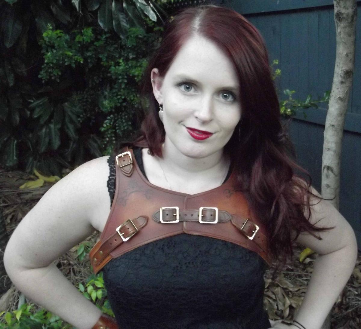

The curve to the straps is an idea I got from a shoulder holster pattern. I really do like the way it sits though and can't wait to get someone to road test this one for me

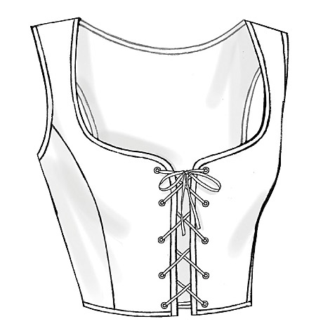

I remember that post that is a great outfit. The starting point for this was a Butterick pattern, pic below. I cut out the pattern pieces for a size 14 in heavy paper and fitted that onto my mannequin, then played around with the shapes till I got what I wanted. I'm planning on making up the rest of the sizes to suit, using the original pattern as a guide for size. I did radically change some of the pieces to get the shape I wanted though, so it's probably not going to be that easy in practise As a general rule though, I'd add/remove half the size change on the back piece and a quarter on each front piece, at the lowest point in the curve. I'll use the other sizes on the original pattern to test whether this will be adequate. With 2 lines of lacing and the buckles on the straps it is quite forgiving on fit though I haven't really had to adjust for cup size too much thus far, my bolero went above the breasts and this is designed to go under them. Actually making something with cups, now that would be difficult! I did try my best to ensure the line of the harness would allow for most sizes but the proof is in the pudding as they say, got to get a few ladies to try it on now

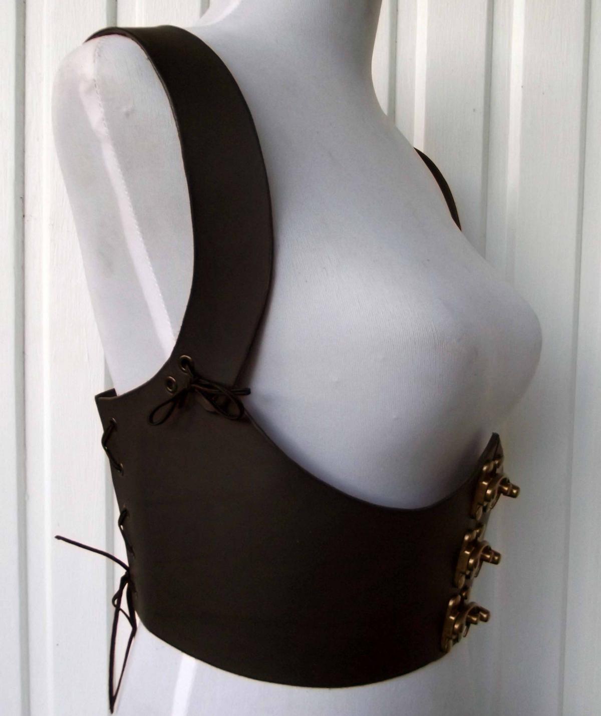

Very first look at the Underbust Harness. I tried for months to get a good pattern for one of these and eventually I drew up my own pattern. Main Features: 3 swing clasps on the front for a very elegant closure. 2 lines of lacing at the rear for a perfect fit. Unique strap design with a laced front and buckle back to provide maximum comfort and fit.
