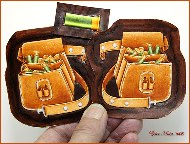

Here are some parts that will be added to some boot tops Peter is working on. ...here a couple inlays for boot tops....there are many more yet to finish, all for one pair. I have completed 16 shotgun gun shells (one shown) and two bags. The very rough looking background area will disappear upon inlaying into the tops...as the brown calf (that the tops will be made from) will kiss-fit (and be sewn) around the shape of these pieces. More to come, Peter
