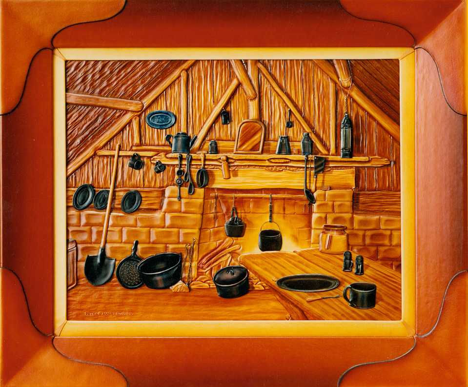

  18. I started playing with embossing and applique in the seventies...unfortunately I have no photos here of that work. I attach a photo of the only early piece I have (1980)...all of the dark pieces are appliqued...I have also used copper wire to make the fire tools, nails etc. ...and all that was only twenty eight years ago! Peter Enjoy, Marlon
  19. Here is a appliqued piece that Al did in 1990 for some friends in Cache Creek, Canada. There are eight pieces that make up this picture... Ann hand sewed the rough-out frame...it is a magnificent piece of art. Peter
