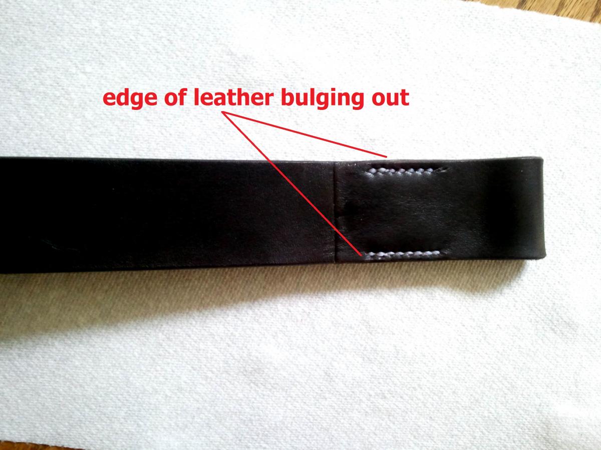

How To Prevent Leather Edges From Bulging Out When Stitching?
thekid77 replied to thekid77's topic in How Do I Do That?
Hey Jim!! Thank you for sharing your experience.....it will be interesting to see what the future holds for the next few straps!! Yeah, this is what I was thinking.....would you go 1/8" away from the edge or further in than 1/8"? Some of the straps are approx 1" in width....Thank you for sharing! Yeah, I'm hand stitching, but I'm using a stitching chisel to punch through the leather.....I'm thinking about trying to polish the stitching chisel since there are some rough areas that are probably causing the leather to bulge out more than it would if it were nice and smooth Hey Oldhat, thank you for your advice....I don't pull my stitches very tight, but I'm going to start tightening them up a bit...I don't have any bridle leather, but I can't wait to get some!! Just have to save my pennies for a while lol !!! -
Hi there, maybe I can clear some questions up.... First, any time things are stitched together, they are usually contact cemented together first with a contact cement such as DAP Weldwood (red or green can)....contact cementing two edges of leather together will add strength to the seam and will keep the leather in place while it is being stitched.... Second, I believe the sticky wax you are referring to is beeswax.....you can buy pre-waxed thread, or just get a cake of beeswax which is readily available from any leather supplier and wax the thread yourself. The wax does help to prevent the thread from slipping while it is being stitched. So, to answer your question, for most applications, it is necessary to cement your leather edges together with a contact cement, and then to stitch your project together with a thread of your choosing, whether it be linen, polyester, or sinew. Hope this clears things up!! Have fun!!

hi everyone, today I was practicing folding leather over itself and stitching through in preparation for making a halter.... I noticed that the leather along the stitched edges bulges out (please see picture) slightly from the rest of the strap that is not stitched..... Is there any remedy for this? I have tried tapping the edges back to flush with a hammer and it helped a little bit, but this method seems really crude... Any advice you could give me is greatly appreciated!!! Thank you in advance
