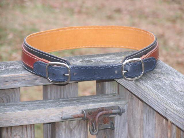

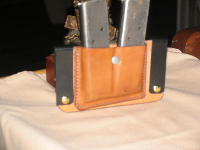

Just asking. I recently sewed a mag pouch. Below is a fuzzy picture. I sewed this using the edge of the leather placing the right single presser foot against the edge of the pouch leather. Do they make a presser foot that is just a little more away from the needle? I also recently sewed a belt. Didn't think about it then, but I could have used the same method. Would like to get a little farther away from the edge.
