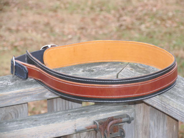

  19. WLG, I use 277 top and 207 bottom for everything I make. Forming holsters puts tremendous stress on the stitches but they hold. Isn't 346 an awfully big thread? I use a Cobra 4 and I like it. The belt is deerskin lined. The deerskin soft lining will not show the "exit holes" like dry leather does. This picture was taken before I had applied oil to the front piece. A sample:
