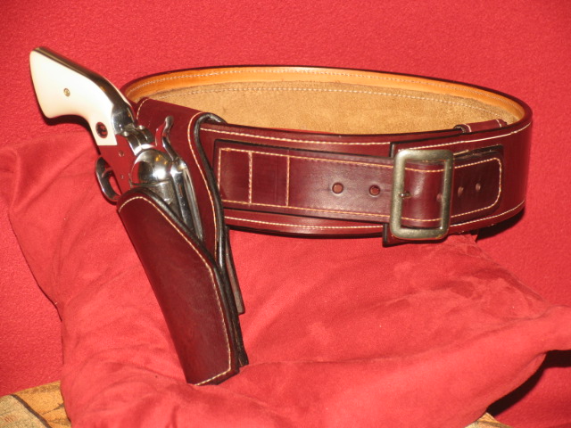

I compete in SASS and I am a gamer. Always legal but not period correct. That is another discussion. Built this rig for a SASS shooter. Remember, speed and ease of access is paramount.
1858 Army Revolver Gun Rig
Red Cent replied to St8LineGunsmith's topic in Gun Holsters, Rifle Slings and Knife Sheathes
OK, explain the dye/stressed/old look. Is the rig single layer? Handsewn? Looks good and different. -

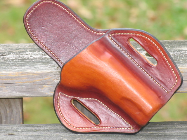

It occurs to me that the lined (2 ply) holsters are very stiff and with a 1 3/4 to 3" gunbelt that is also 2 ply, the holster will stay put without a lot of help. Anything less than 8-9 ounce will be soft and pliable and would be a little floppy. Especially without a good stiff gunbelt.
If you are making modern type cowboy holsters, there is another way. My holsters are 2 ply. I punch holes in the outer and capture chicago screws between the leather. I use Weldwood Cement to glue the leather together and put a little bit around the screw caps. The back flap is integral with the holster and two holes are punched in it also. The male chicago screw is tightened down. You can see one of the screws on the bottom of the back flap. There is another one just below the belt. That keeps the holster in one place. In cowboy competition, you don't want to keep positioning the holsters. Some cowboys punch a hole in their belt and in the back flap and attach by a chicago screw. Hope I explained the process. The second picture also has the captured chicgo screws. Some holster makers (Kirkpatrick) sew a leather block to the inside of the backflap just below the belt line.

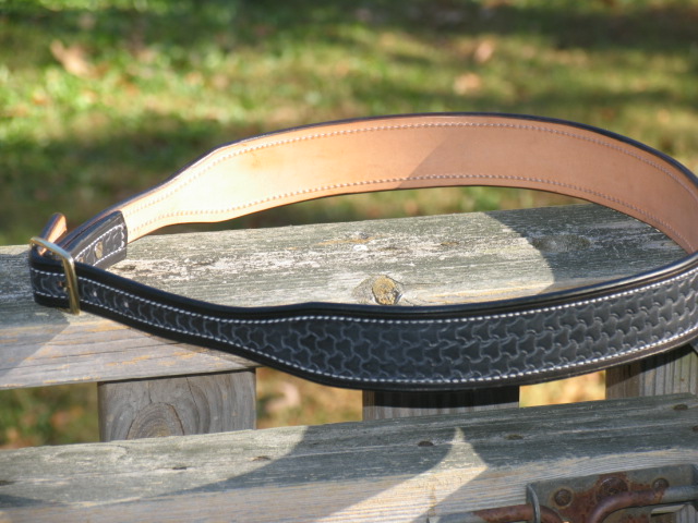

A lined belt that will equal about 14-16 ounces is the thing for concealed carry. If not, alined belt totaling 10-12 ounces is sturdy and looks very good stitched properly. Single layer dress/casual belt are good. I have used Welwood for months and the other day it came to me - heat gun. And I read it here somewhere later that day. You use a heat gun on Wledwood to accelerate drying and you better be lined up when you put 'em together. And a rolling pin. -
