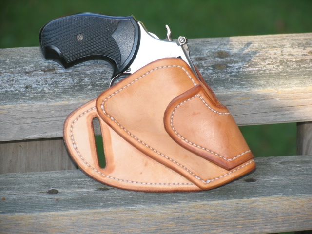

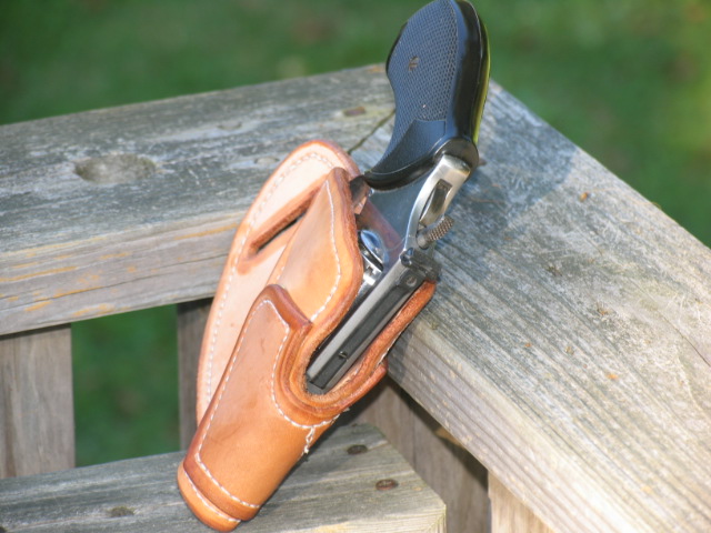

http://i229.photobucket.com/albums/ee189/redcent69/Leather/009_zpsdea639f1.jpg http://i229.photobucket.com/albums/ee189/redcent69/Leather/011_zpse49b1b94.jpg If you use a liner, cut holes in the liner and capture the chicgo screw female side. If you do not use a liner, cut a small rectangle of 4-5 ounce or better, puch holes, glue and sew on before you close the holster. Most crossdraws do not use all that leather in the picture as seen in the above picture. You could stop halfway down the backside of the holster or less. -
