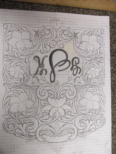

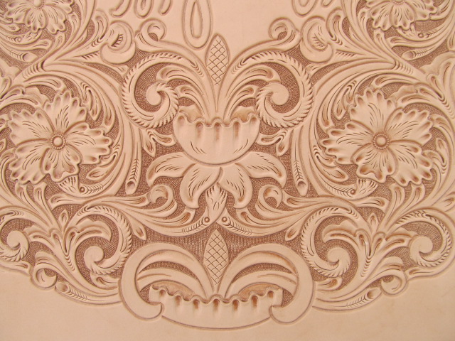

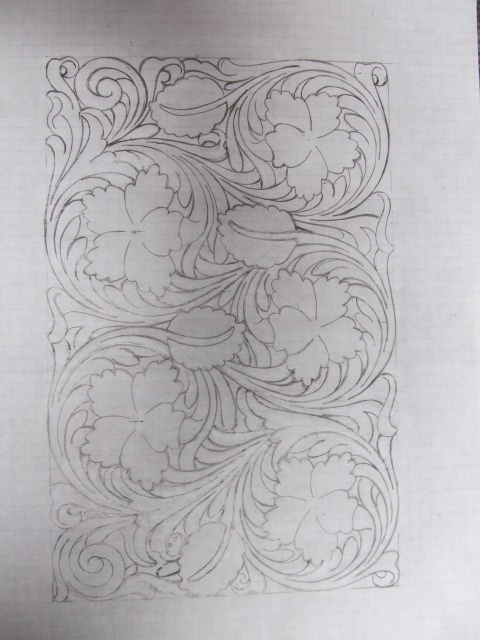

Here is some pictures of a drawing and the tooling. When I draw a pattern I try to make the background area as small as as possible. Then when I trace the pattern I draw outside the lines. Then after beveling and bar grounding the background areas still come out to big. The bar grounding and dying take a lot of time and the smaller the area the less work on pieces like this anyway. There is four of these. They are 2 bench seat covers going in a 71 International Harvester Travel All. The Logo was suppose to be tooled into the big piece but when I was laying it on top to see where we wanted to put it they asked if I could just sew that piece on top for some depth. Black outside with the Choc. Light Brown tooling. The basket weave border will be red with the I red and the H black. Not sure about the area around area around the IH.

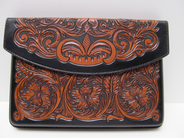

Thanks Gary. Each side took about 7 hours. It usually takes a little over an hour per circle plus some time for the fill in areas. -

My wife finally said something about a tooled handbag. This one matches everything she carries. The handles are from the old one she carried that I used as a starting point. -

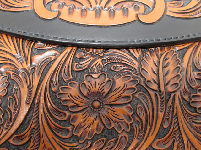

That tooling is dyed with a 50/50 mixture of chocolate brown and light brown and thinned 50/50 with thinner and sprayed thru a automotive type spray gun. A gravity fed gun. I spray really light coats. That probably has 10 coats. I spray everything brown and then go back and dye the black. Then I spray Wyo Sheen for a antique blocker. That really changes the color and its what makes that brown look like that. The Antique adds a little color too. Sheridan brown antique finish. All Fiebings dye and antique.

Thanks Ryan. I am drawing all my own tooling patterns. Black dye for the background. I have the Sheridan Style Carving book and Bob Parks Western Floral book. Helps when you can draw a pattern to fit any shape or size.
