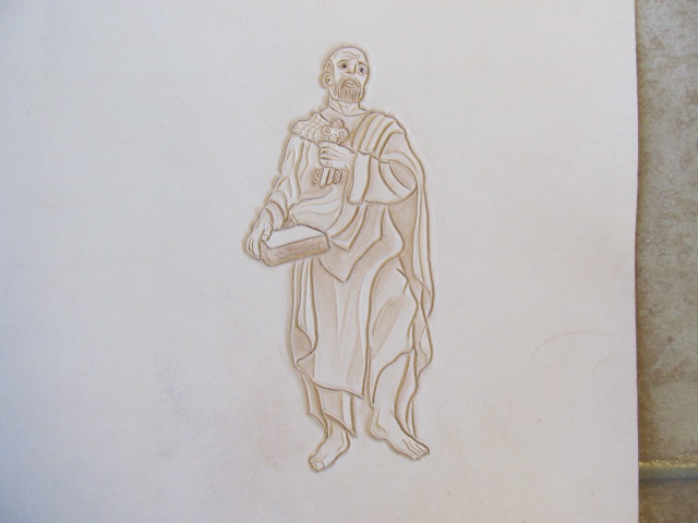

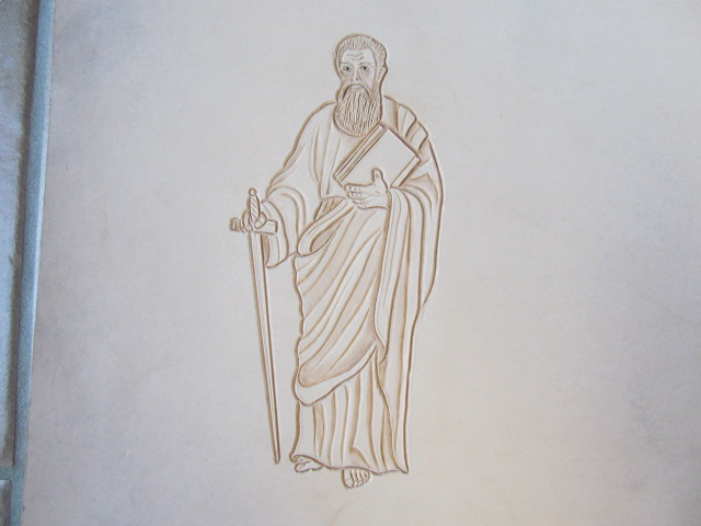

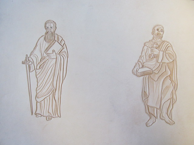

Hi Tom, Thanks for the positive comments. Moisture is one of the main things to get right when it comes to tooling. Here is a couple of pictures to see the difference. The one with the CC initials was to wet when I tooled it. I am still a little impatient. It looks a little mushy. When the leather is just rite the tooling will leave a darker color. The beveled lines should looked burnished or darker. Same as the thumbprints or pear shaded areas. You can see the flower centers are not near as crisp as in the other picture. Hidepounders casing tutorial is the one to follow. I fill my sink with water, slide the leather thru the water and you will see air bubbles coming out of the back. You don't need to wait until the air bubbles quit coming out but you need the water to penetrate all the way thru the leather. Then I put a piece of glass on it covering the whole piece for 24 hours, then take it out and let it dry until it is almost back to natural color. Both of those are tooled on 2-3 ounce leather. Good luck
