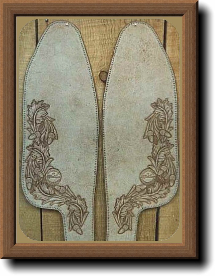

Make sure you use buff rough out leather. The stamping will stand out a whole lot nicer than nappy leather. Make sure that you case the leather well. If it is to wet the image of the stamp work will show on the other side. Here is an example of a pair of rough out fenders that was stamped.
