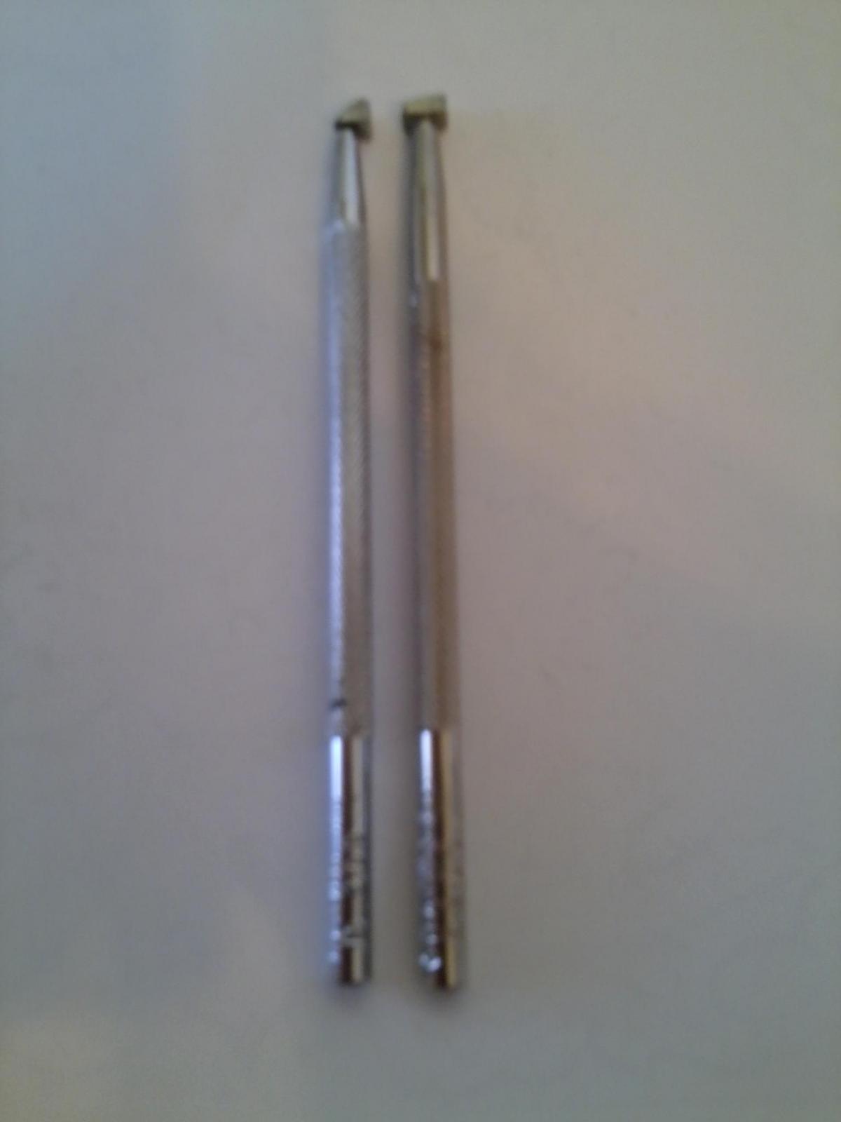

Okay, I'm about to invest in some Barry King tools. I've done mostly art work for a few years and am going to start trying sheridan carving now. I'm not sure which to buy and can't afford both sets at the moment. I'm sure it's a preference thing but would like opinions please. To show my ignorance on the subject where is a leaf liner used, and do I really need it and a center shader? I can't make up my mind if I should go ahead and buy the 400.oo kit or just grab a couple of bevelers and thumb prints. Somebody knock me off this fence, lol. Thanks Troy
