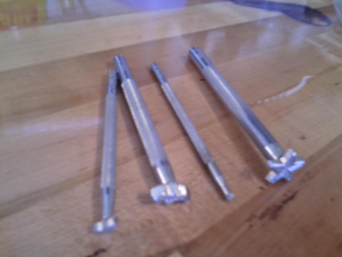

I have a few craftools in the Z series. They look like those but I thought they were made in Taiwon ( however it's spelled). I went to my shop and took a file to one and it was stainless steal. My pic is terrible but they look like them to me. However the basket stamp on my ct is a X series and the 7th from the right is a S series. The leaf third from the right and the first one on the right is a L series but your pic doesn't show the numbers. I bought a fella's tool set years ago and these were mixed in so mine are fairly old tools. I'm a little suspicious about the wrong lettering because I have about half of them in your pic that are labeled V, C, etc not Z. The pic is worse than I thought. If you need it I'll find my good camera and take another.

Your going to have to post bigger pictures for me to help. I can't see the ends good enough. The bottom one is a modeling spoon on one end and a stylist (used to trace patterns among other things) on the other. I think I see a hair blade and a groover but I'm not sure. -
