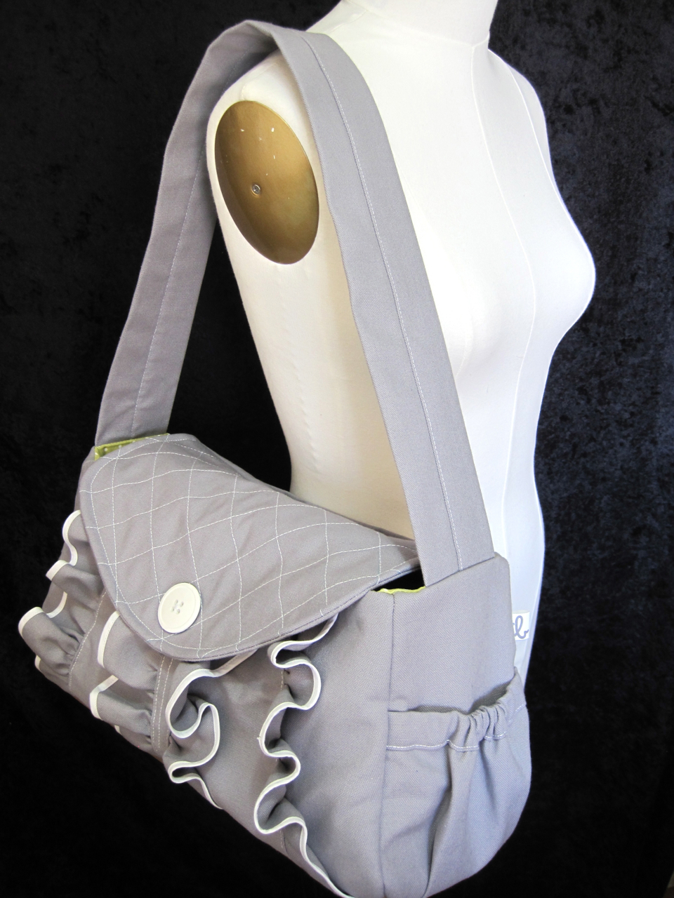

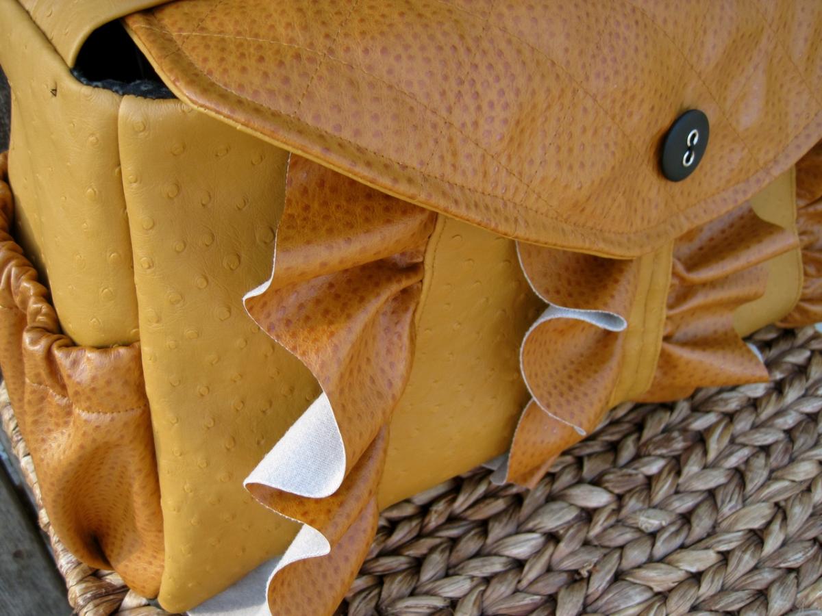

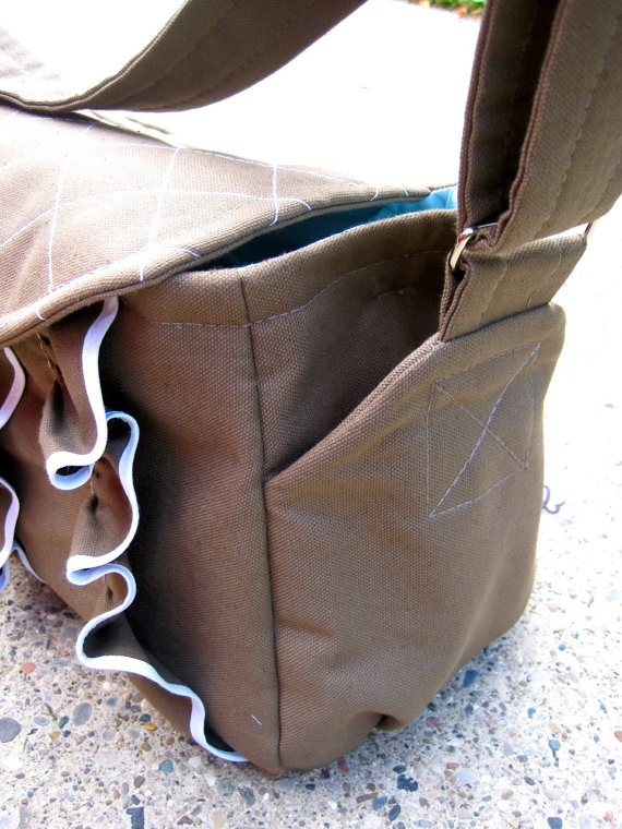

  13. Here's my introduction. My name is Dani, I live in Michigan, 27-years-old, stay-at-home mom to 3 small boys. I've sewn all my life, started making/selling patterns and that moved me onto making bags (cute diaper bags) and baby carriers. Now I've gotten into seeing the beauty of old sewing machines and have really become quite obsessed with them. Now I buy/fix-up/sell them as a hobby which usually includes re-wiring motors and taking everything apart to clean really well. I'm starting to realize I've really done myself a disservice and to my customers by not using the right kind of sewing machine/thread for my products. My products would be SO much better if they had the thicker/stronger thread and would look more professional too! I also teach sewing classes and would love to give my students (young mom's like me) the opportunity to sew on an industrial machine and see what is out there besides just their cheap plastic Singers I found leatherworker.net by looking into different models of machines and have really gathered a lot of information on this site. I appreciate the knowledge and experience of others and their willingness to help people like me! My blog: theprojectlady.blogspot.com My pattern shop: twirlybirdpatterns.etsy.com My product shop: twirlybirdbaby.etsy.com
