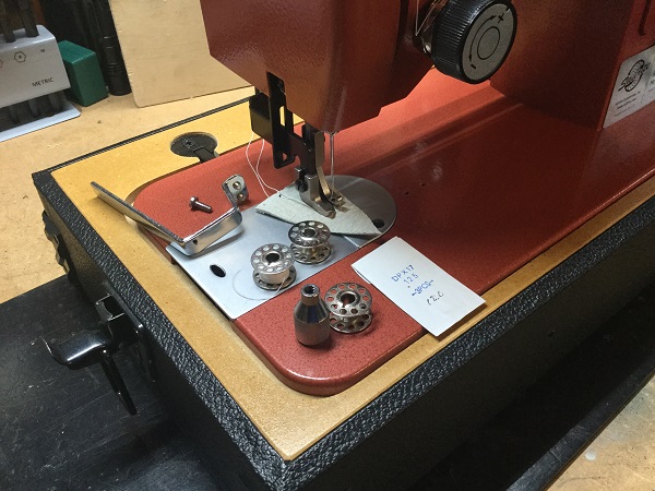

Selling my Sailrite Ultrafeed LS-1 machine. Used twice. Will handle up to 92 thread without difficulty. Has reverse. Equipped with the EZ set stitch length plate. Comes with needles, bobbins and detachable thread stand. Is set up in heavy duty carry case (see photo). $500 Prefer local pick up. Metro Detroit area.
