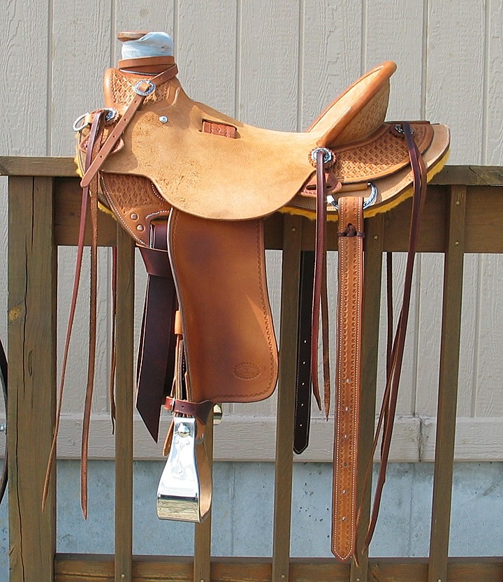

Thanks for the kind comments everyone. Regarding the stamp job..........the center part of that diamond is a stamp I got from Jeremiah Watt's Horsehoe Brand. He calls it the Navajo stamp, I believe. I have played around with it quite a bit, and have several ways of using it that I like, although I think this pattern on this saddle is my favorite. I don't know if I really know how to run this stamp correctly or not. I simply saw this pattern on one of Jeremiah's saddles, and tried my best to copy it. The way I do it is to stamp the the navajo diamond centers first. Then cut the lines with a swivel knife, and then the dots with a seeder. For me, any way, I have found that this allows me some wiggle room to get the lines and seeder dots looking pretty well lined up. JW
Below, I hope, are a few photos of a saddle that I finished up today. It is my 4th saddle, and my first Wade. I sure appreciate all the wisdom offered here. Thanks, JW
