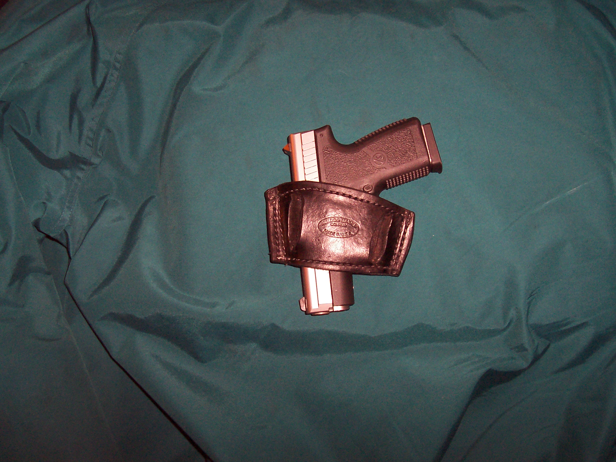

Last Thursday night I picked up a new KAHR PM45 pistol. I wanted to start carrying this pistol both on/off duty ASAP. My department only holds mandatory firearms qualifications twice a year and requires holstered weapons for the qualification stages. Friday afternoon was range qualifications and I needed to build a holster quickly. I designed and built this holster in just over an hour not including drying time for the dye. The holster itself is a beltslide that rides between my belt and trousers. I made the holster from 2 pieces of 6/7Oz. veg.tan with calf skin lining. The holster is real small and when I remove the weapon, it's hard to tell I'm wearing a holster at all. Next, I'm building a pocket holster for the Kahr. Randy
