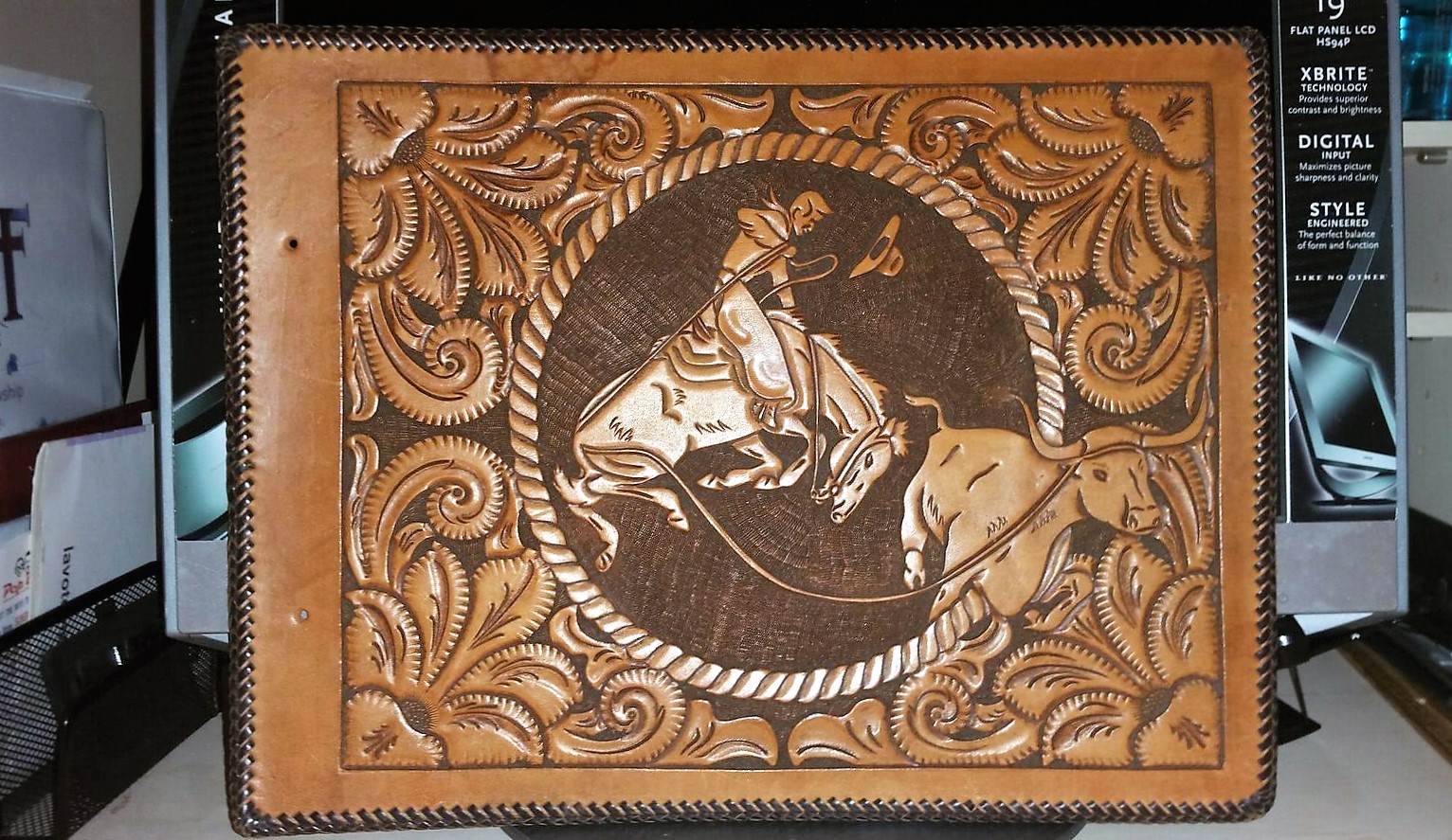

My sister surprised me by sending the following photo this weekend. Hearing that I was starting to get active in learning to carve and tool again she thought I would like to see a photo of an photo album cover I did for her some 50 + years ago. I had forgotten all about it. Had to be around the time I was living in Payson, Arizona. The pattern was one of Al Stohlman’s if I remember correctly. Anyway, I thought some of you may be interested in seeing it too. -

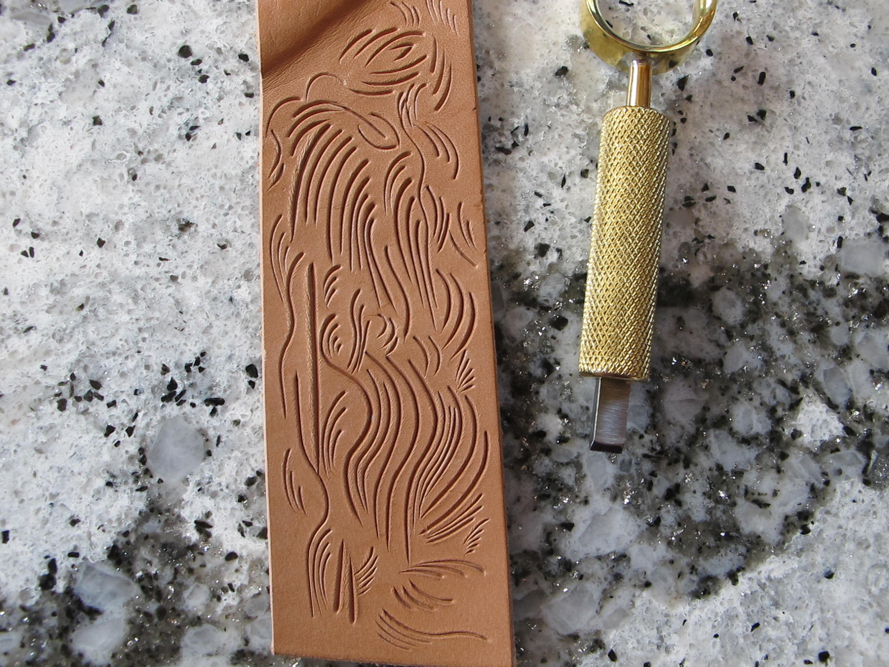

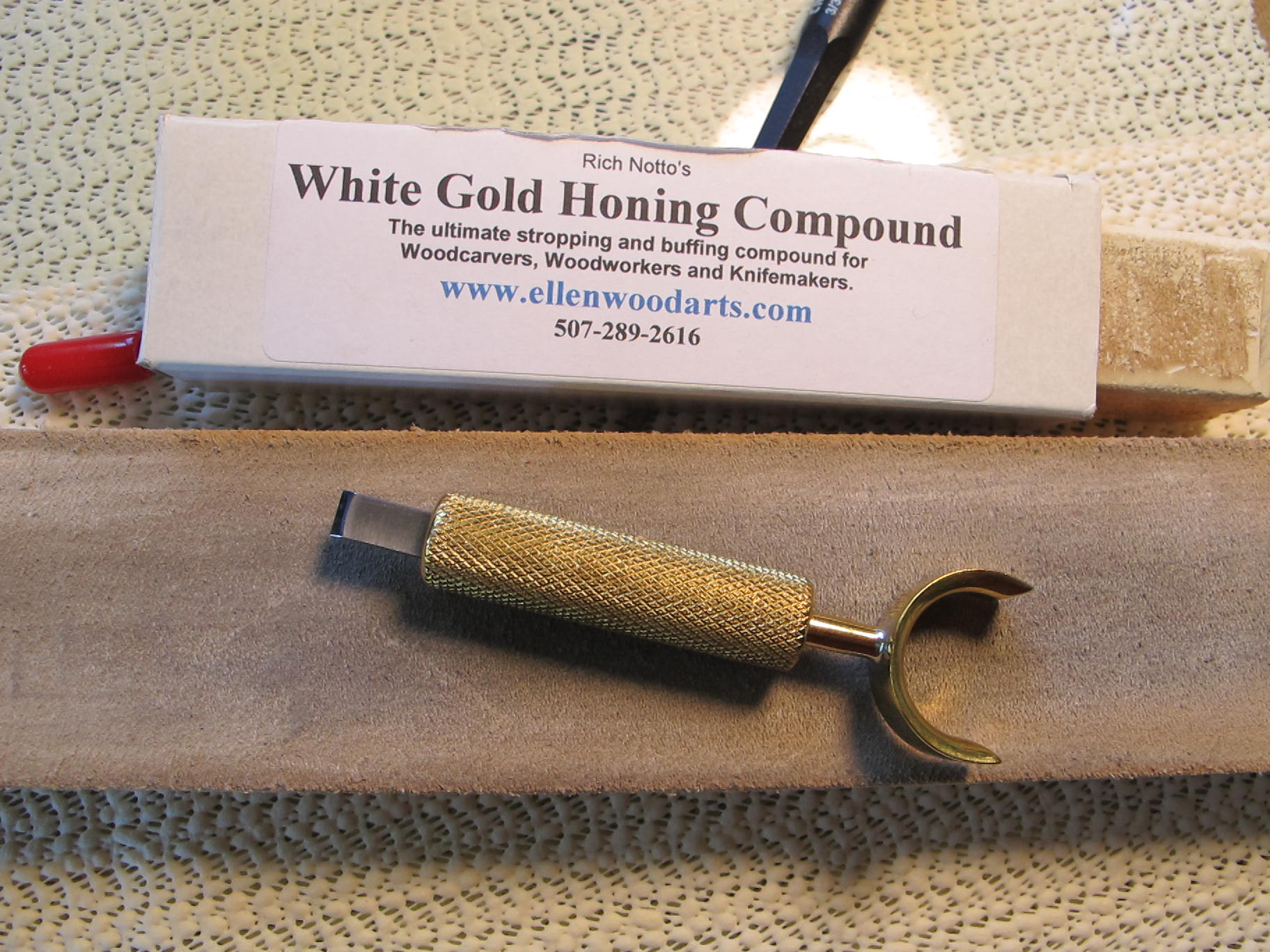

Thanks for the encouragement Bob. I did manage a short session of freehand practice this afternoon and the next session will be to get after the practice patterns starting on page 16 of Sheridan Style Carving. Something I found interesting was the mention to try pushing as well as pulling the swivel knife. Tried a little of that and now want to try more of the push stroke...... interesting. Here's a couple of photos one of which is my stropping setup and the other how my freehand looks with the first attempt with the Barry King swivel knife. What a difference compared to my old Tandy that I managed to hang onto all these years. I'm going to like getting use to the Barry King. AT this time casing the leather to the right point is going to take a bit for me I think. -
