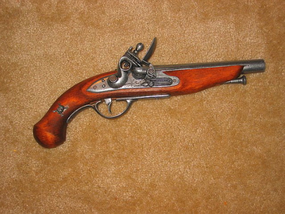

Hello everyone, I don't do a whole lot with leather I mostly mess around with braiding. My nephew asked me if I could make him a holster for this replica gun for him. I'm not sure if I am capable but I said I would try. Can anyone point me in the right direction as to how to go about making or finding a pattern for this gun and what weight leather should be used? Thank you for your time Rob
