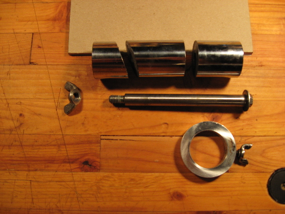

    String cutter
    Thought these might help someone understand a little better. Rob

  4. I second that, I tried a couple of white tailed deer last year and ended up throwing them away. They are very thin and if they weren't so strechy would have been nice for knots, but it was almost like working with hard rubber bands. Rob
  5. rgerbitz
    String cutter
    Yeah sorry about the dimensions. It is 5.5 inches long by 1.5 inches in diameter. I like the diameter but having it be a few inches longer would be nice. Rob
  6. rgerbitz
    String cutter
    I was asked for some more info on my string cutter, so here it is. There are a few things that I am going to change when I get a chance: The collar needs to be off set or a finger added so that the string is not against anything after it has passed the cutting edge. I have troubles some times when the strings are thick and a bit to dry wedging in and either breaking the blades off or busting the string. ( which I would rather have happen when cutting string than when braiding) I would also like to add another angle for beveling the current one is a bit steeper than 45 and I think one closer to 30 would be nice at times. Otherwise for the price it works great. I don't have some of the fine tuning that it looks like some of the others have but I am finding that the more I use it the better I get along with it. I have about $200 wrapped up in the splitter and cutter. If any of this is unclear or someone would like some more info or pictures I would be more than happy to help. Please do not hesitate to ask. Rob

    String cutter
    I think I have posted this before, I am sorry if this is repetitive. I had this made at a local welding shop. It is made from a solid piece of hydralic ram. It is nothing fancy, and there are a few changes that I am going to have made to it some day. But it works well for cutting rawhide and roo. I paid $50. If a guy was handy enough you could make one out of hardwood that would work I would think. Let me know if you need more info, dimensions, better pictures... etc. Would be happy to help. Rob

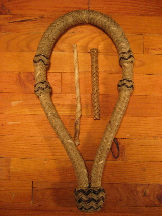

    Here it is my first roo hide piece. It has a twisted rawhide core braided over with rawhide then with the roo. To make a 1/2, 12 plait bosal with a 20 plait nose button and a over 5 pattern on the heel knot. The side buttons are spanish ring knots of three passes. I used vaquero rawhide cream on the strings while braiding,( that I bought from Opagon) worked great. On the nose button I braided an over one braid down then turn both ends back. There are a few things that I will do different next time, and I will see if anyone can see what that may be! Thank you all for the help in the previous months with the info and encouragement I have really enjoyed working with the roo. I would appreciate any pointers as to what might have been done differently or better. Thank you Rob Gerbitz

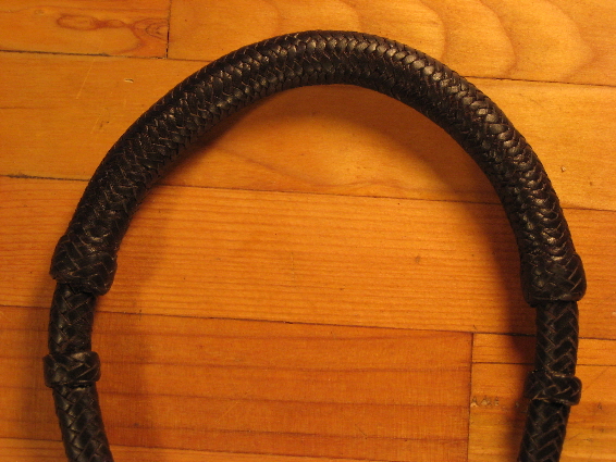

  19. Just finished this up this afternoon. Thanks to all the rain I have been able to get caught up on all of the rainy day projects like this. It is a 3/4 inch bosal with a 12 strand core or cheek and a 24 strand nose button. There is a twisted core that was braided over twice. I would welcome anyones critique. Thank you Rob Gerbitz
  20. It all looks well done Roo. You and your Mom sure keep yourselves busy with some braiding. Rob
  21. Hey Alan, Thank you for the heads up. I had just spoken to the man that had ordered up this bosal on saturday to clarify what it was that he was wanting. Because to my mind as well, 1/2 inch is quite a bit to put under a bridle. Good thing to, because he may know his gear but he doesn't know the difference between 1/2 and 3/8 without a tape measure in front of him. Rob
