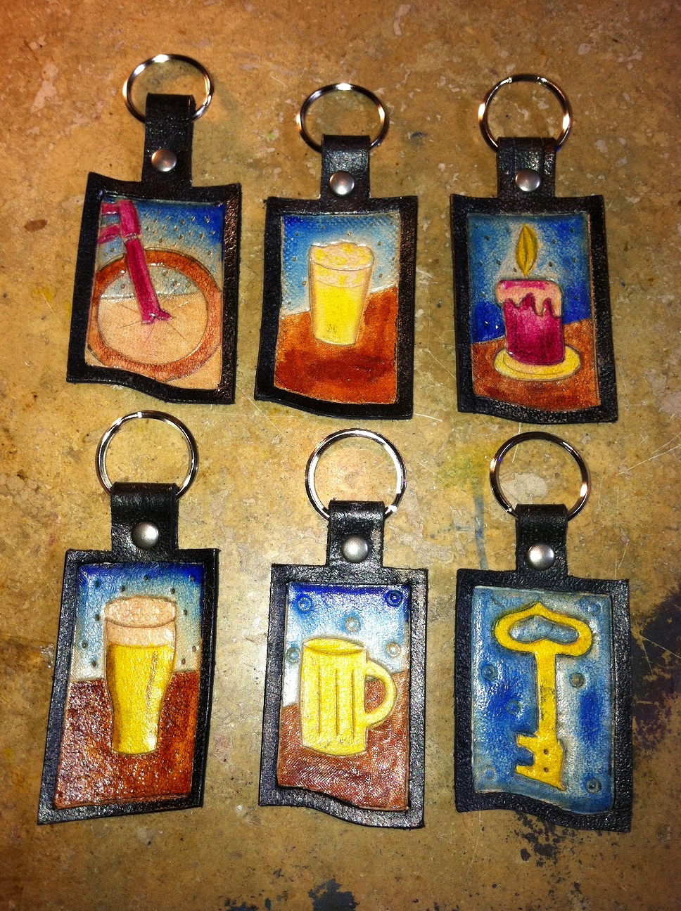

Needed a change of pace from doing some of the wallets, etc that I've been doing. Wanted to make something that was fun and 'stress free'. These are about 3" x 1.6" and dyed, not painted. Trying to get a water color type look on leather with dye is difficult. I'm open to any and all suggestions.

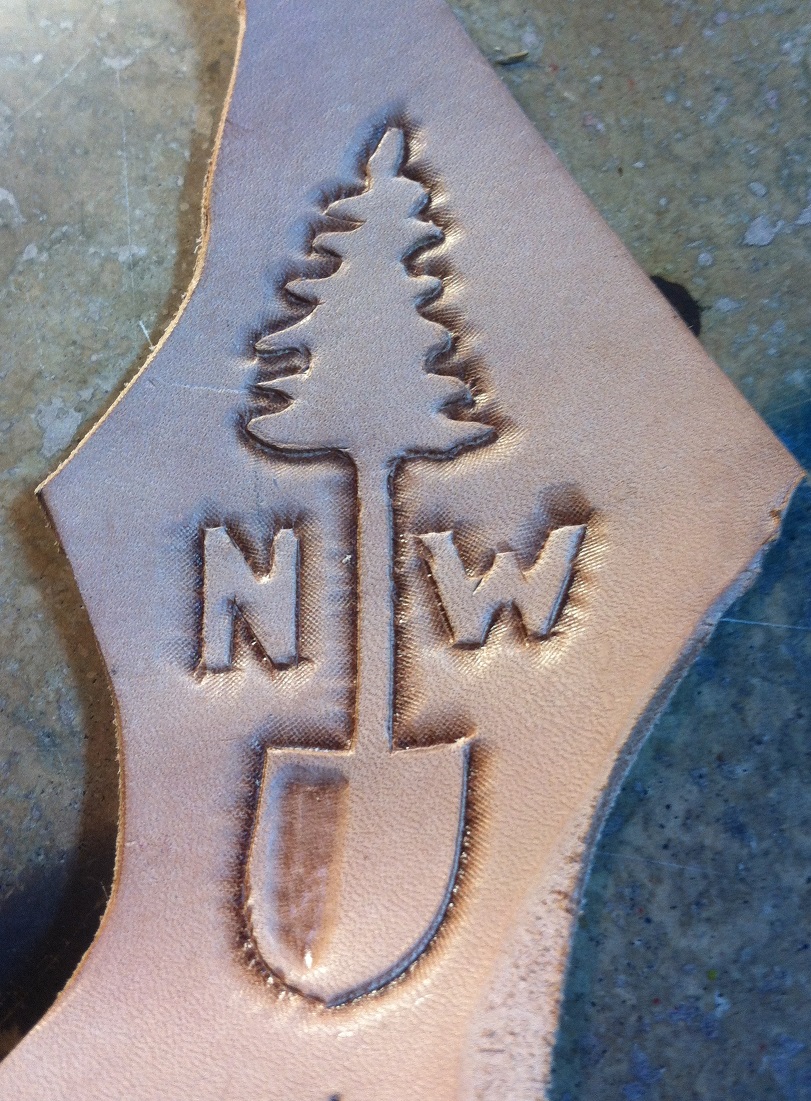

any thoughts or suggestions on these pieces? I used a strait edge for the strait lines of the letters in the "roast" one.

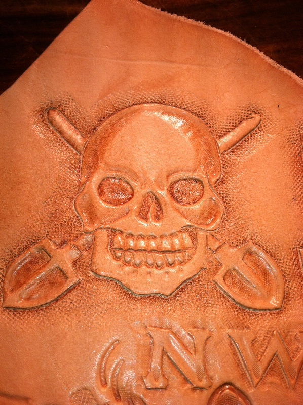

The whole reason I got into leather tooling was to make a seat. Pretty impressed with my first try. I did an antique rub on the skull and dark brown dye on the rest. Then a few coats of clear.

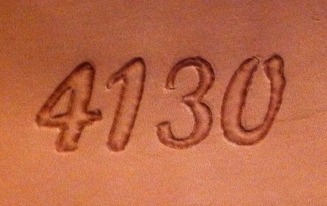

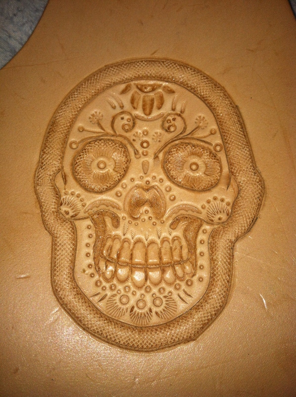

I posted one of these in another section because I didn't realize there was a specific section for tooling/stamping. I have super cheap tools and a tandy knife. I need to get stropping paste because the knife is very dull. I'm stuck with these tools for awhile because I can't justify spending $25.plus on just one tool. I have no interest in what I would call "traditional" or western style stamping. The subject matter is what drives me to want to pick up the tools and stamp. I have a hard time getting the teeth too look right. The knife either isn't sharp enough (It's very dull) , won't make such tight corners or I need more practice with a sharper knife. I also find the tools to be very small. Hard to hold onto and hard to see. :/ I plan to use this thread to post my latest works and hopefully see some improvement over time. Any and all suggestions are welcome.
I find that holding onto the small tools (like an A104, etc) hurts my hands. I have some hand/health issues and holding things that are small gets very painful after a short time. Is there anything I can add to the handles to increase the size? I may end up just wrapping tape or something around them. Thanks
