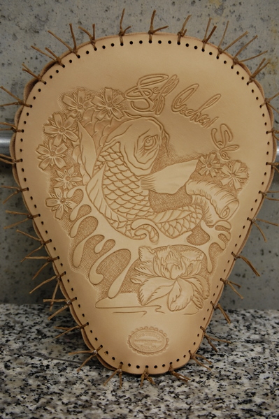

  9. This is the seat that I am currently working on for Jeff Cochran. He may want to leave it natural; as you see it here. Trying to decide on the best lace color. Any suggestions? Should I do a row of decorative lace on the front too? What do you think? Dave Theobald

    Read more

  19. I'll try to answer some of the questions. 1. Padding thickness. Depends on the seat pan style. Is it designed to be the thin chopper style seat? Or is it one of the thick padding seats like a stock HD seat? For the chopper style, 1/2", 3/4" or 1" is about right. 2. How much larger do the leathers have to be than the pan. If you are doing a chopper style seat with 3/4" neoprene padding. They should be about 3/8" larger than the pan. You understand of course that the top and bottom leathers are not the same. You will need to make separate patterns for both. If you are making a thick padding seat there is no back. You have the top and a side piece of considerably thinner leather. 3. Rivet the back to the pan....no glue at all.... at least in my seats. Well, the padding is glued to the pan but no glue on the leather. I encourage you to teach yourself to lace. Tandy has a small booklet call How to Lace......It's less than $5. It isn't rocket science, give it a try. Dave Theobald
