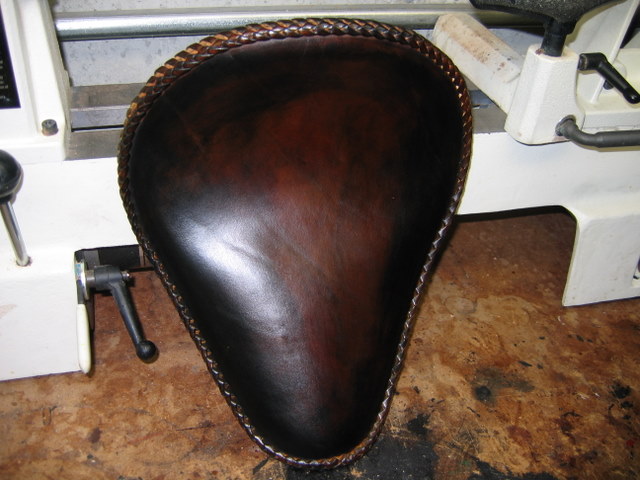

  2. I do use antique paste all the time on seats. I only use the alcohol based stains. On this seat I kept working back and forth from dark to light and medium colors. I used black, dark brown, medium brown, sheridan and buckskin dye; all by Fiebings. I show pics of the seat not because I think it is so terrific but to show the results when the dye is applied nearly dry on a cloth. I used sheriday antique paste when I was done to help blend all the colors. A final coat of leather balm with atom wax as the only finish. Dave

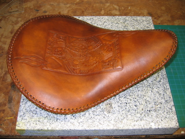

  7. I recently had a customer send me a request for some art for their next seat. This is a repeat customer for me. I just finished assembling the seat.... color comes next. Dave Theobald

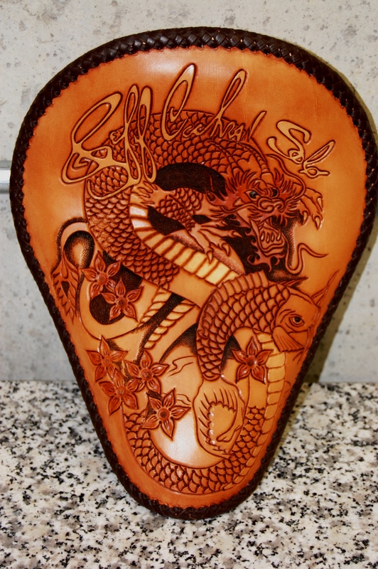

  14. Here's the first bike from Jeff Cochran's new shop. Speed King Jeff Cochran Solo.
  15. Thanks for checking this out, I just thought a few folks might want to see where those signature seats ended up. Dave
